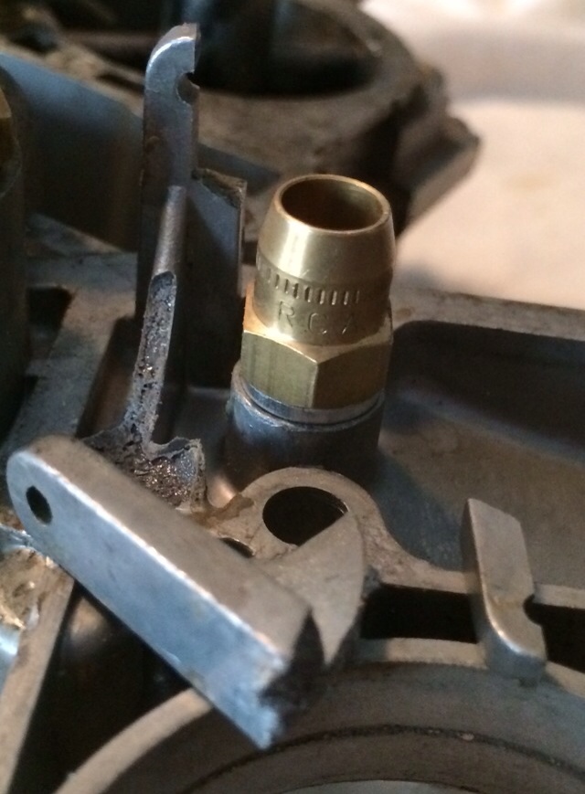

Hello fellow paso enthusiasts,
I have recently found myself needing some help with the Weber carburetor for my paso. When I was trying to clean out and adjust the carburetor, to get ready for some good riding. I was taking off the big brass bolt that holds the little fuel filter on the fuel inlet and the wrench slipped and I snapped off the towers that holds the float. I am sure you can imagine what came next :banghead:. So now I am in need of a new top plate for my carburetor. I know that there are a few of you that have done the carburetor swap and was wondering if anyone would be willing to part with their old Weber.

this maybe dumb but I will ask anyway. If just the float towers are snapped off, could you use JB Weld to bond them back on again? That stuff is amazing and has bonded lots of busted cast aluminum parts before. Just a thought...
 Post subject: Re: A Call for Help
PostPosted: Sun Mar 02, 2014 10:54 am
yes you can :idea: make sure you use the marine fuel resistant variety. Devcon also has a two part epoxy which adds aluminium powder to the mix and is very strong. Strong enough to repair transfer ports on two cycle cylinders.
there is also a product called alumalloy which can be used depending on your level of skill

image.jpg [124.29 KiB]

alumalloy works like solder but is for aluminium parts. All you need is a butane or propane torch. Normal JB weld won't hold up to ethanol but Devcon of the proper blend will and so will alumalloy. In the mean time I just fired off an email to one of my Maserati guys bought a carb from me a while back and I seem to remember he was replacing one that had other issues so he may have a good top for you

You can make very fine 'welds' with Alumalloy / Lumiweld etc. It is a Zinc alloy and has a lower melting point than Aluminium. The only drawback being when the working temperature is reached the Aluminium will be soft as it is now near to its own melting point. What this means is you cannot clamp the Aluminium with any force since this will push the Aluminium out of shape. That looks do-able, I'd be tempted to have a go. I recommend creating a Zinc powder from a Lumiweld rod and coat the fracture surfaces with it. Got a lot of cavitation within the parent metal so a Zinc powder will fill nicely. Then accurately and gently jigging the pieces together, heat the break area until the Zinc powder melts and joins. Don't use a plumbers blow-torch but a butane micro / pencil torch. Its scrap otherwise so what have you got to lose (apart from $500)? The picture here shows the join of two pieces of Aluminium by a single stroke of Alumalloy rod along the weld site. Not the method you should try at first with your repair but what it shows is that very small and intricate welds can be made.
