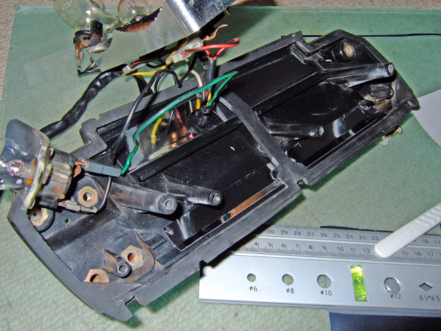

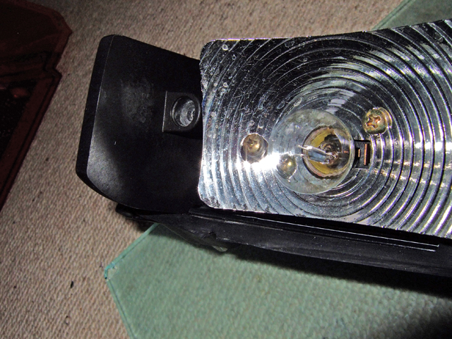

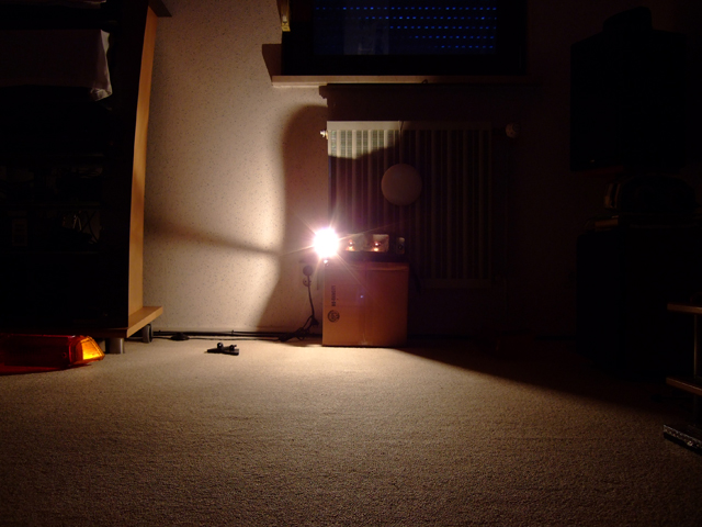

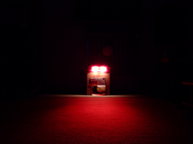

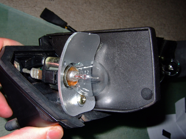

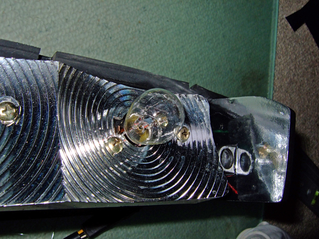

I`ve never liked those black dividers between the taillight and turnsignal reflectors and after a tip from Claude I`ve now tried what he did and covered them and some other bits with chrome foil. (Needless to say that everything needs to be cleaned and degreased and never touch or wash the chrome reflectors!)
some foil was added on the back (which might be unnecessary)

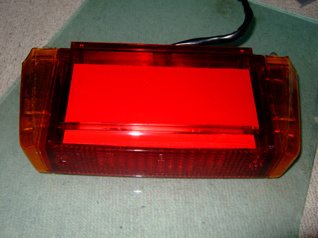

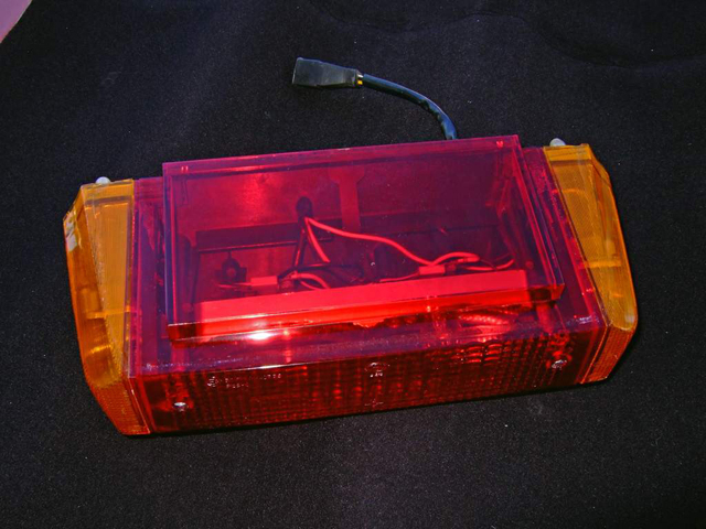

inside the taillight lens
and on those dividers
now the differences in the pictures may look disappointing but then you must figure that this is inside the house and staring directly into a 5W bulb and the camera turns down the shutter so it`s things like the shape of the glare around the bulbs, the width of the bright line on the floor or the center red spot on the carpet that show that the modified taillight on the second picture is a bit brighter than the original one on pic one.

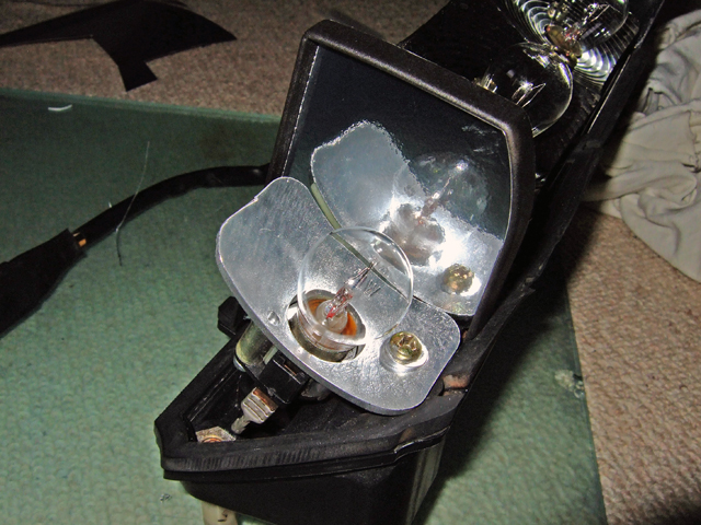

the turnsignal with the lens removed. The divider with the chrome foil on it increases the scattering angle and also ads a bit to the brightness (pic.2)
I didn`t expect miracles but there is an improvement over the original taillight and it`s cheap, too.
