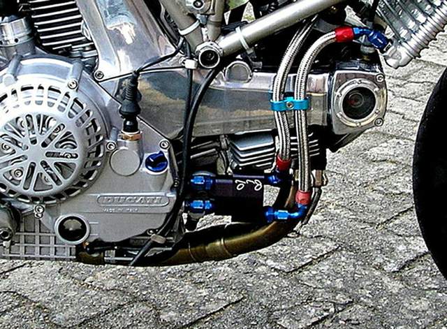

I have an oil thermostat from a Monster/SS and am wondering if it can be adapted to the Paso.

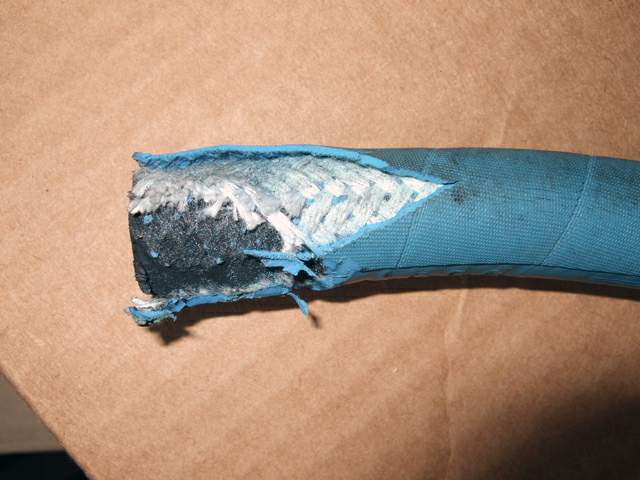

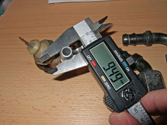

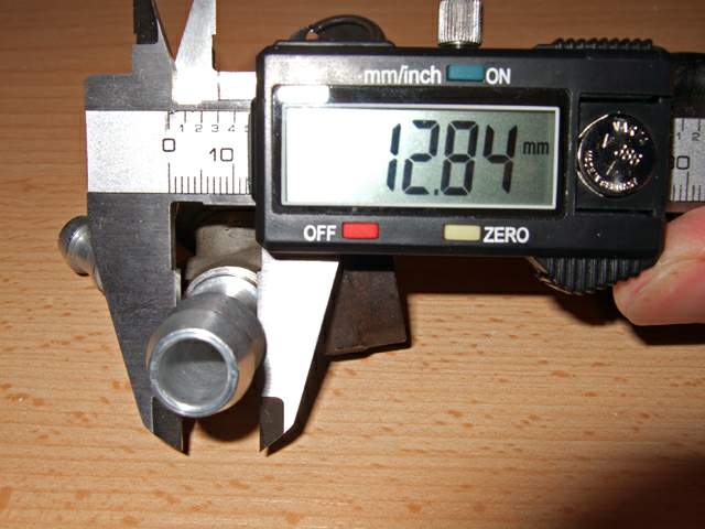

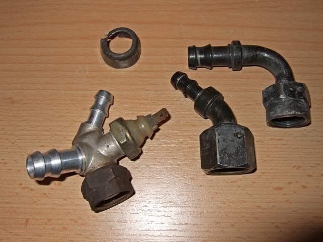

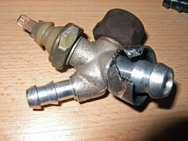

Cut one old oil hose into bits as I was curious about the size and type of the adapter pieces.
I was told (by the hydraulic shop) that the end pieces would have to be removed which I did but they are not crimped on as they assumed. They are just a protection and safety for the hose and should not be removed. (hence if someone has a spare oil hose, preferably an old defect one let me know ;)
The oil hoses have 3 layers so hairline cracks in the blue cover don`t mean much.
The hoses are only pushed on.
The hose nipples are 9,5mm (from one oil cooler to the other) and 12,8mm (from the engine to right oil cooler).
Hence fitting push on hoses would be 3/8" (9,65mm = D-06) and 1/2" (12,7mm = D-08).
(note that hoses that are not for push on installation might be also classified as size D-06, D-08 etc but may vary in inner diameter. I.e. Steel braided hoses like the ones on that SS above won`t work. Not only because of the different inner diameter but also because the don`t expand. Btw to install push on hoses don`t oil them. Put them in warm - not boiling - water for a while to soften)

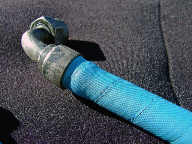

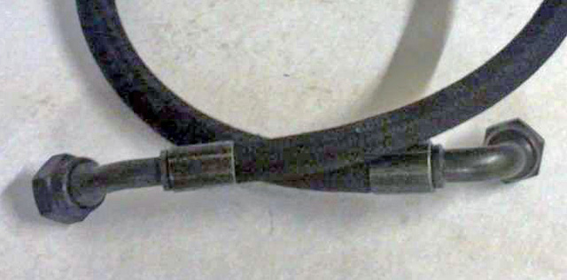

obviously there were also oil hoses with crimped end pieces
 Post subject: Re: thread oil line adapters ?
PostPosted: Thu Jan 22, 2015 10:54 pm
they are all of the same basic design G, banding is stronger than crimped but involves a more expensive process to get the band on and barbed and banded is strongest of these types of multi-piece hose ends
and oil is a universal solvent so in the end they all leak
PostPosted: Fri Jan 23, 2015 10:09 am
ok so the correct term is banding not crimping. Still, all three sets of oil hoses I have are neither nor. They are just push-on. There are no pressure marks on the end sleeves and one can rotate them by hand. Also if they were press fitted they would be longer like the ones on the last pic I posted.

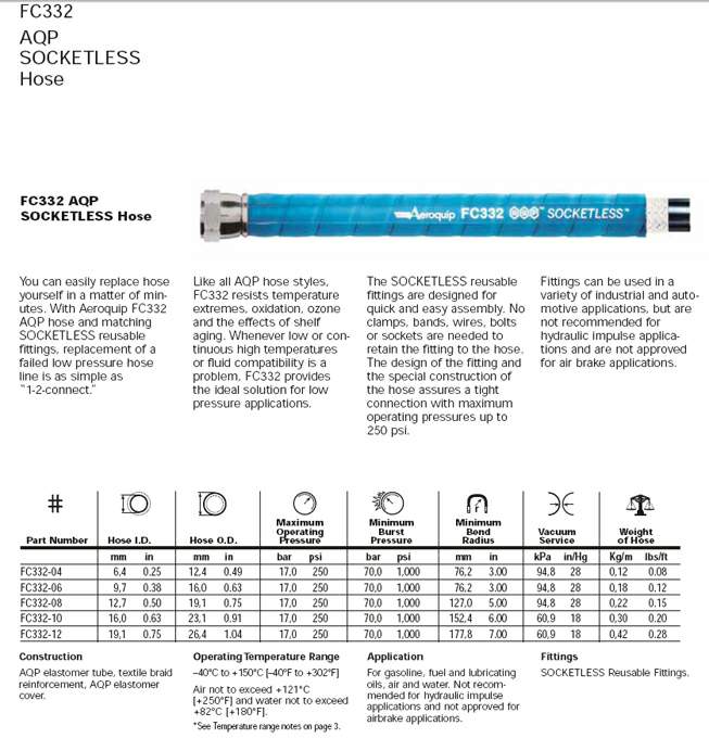

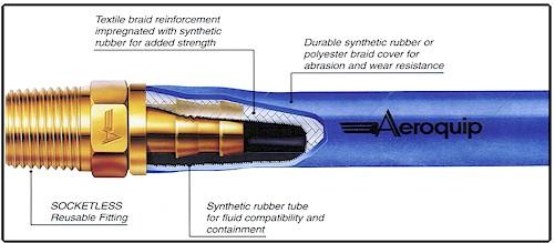

PostPosted: Wed Jan 28, 2015 12:58 pm
those original blue oilhoses are from AEROQUIP and can still be found w/o problems.
The larger one is the FC 332-08 and the smaller one the FC 332-06
