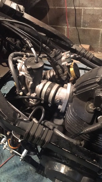

Greetings! I've been motivated by your helpful advice and done some work toward resolution.
Pictures after my tank and fairings removed reveal a dirty girl that needed to be sanitized, greasy pods, and degradation of the rubber booties at the manifolds and throttle cables. The hairline cracks on the manifold booties are not ruinous yet, but I will find and order new boots.
i could tighten the attachment bolts on the vertical cylinder's Malossi manifold about 1/16 turn, the horizontal's manifold was super snug. Vacuum plugs on the manifolds were snug. I turned the screws on the rubber boots's hose clamps 1/8 turn apiece. They feel very tight.
The 40's are perfectly synchronized. One clack on throttle release, and I could observe that synchronization visually as well. Fuel hoses are a 5 years old: not as pliable as new, but in good shape w/o cracks or holes. No weepage or wetness observable. As you see, the set-up is simple: no return lines.
The floats seem to work: no weepage or leaks from the bowls. Very dry and stays dry.
Plugs electrodes seem a nice enough brown. I'd say it was running a tad bit rich, pro'lly because I swapped out the F1 cans for stock muffs about 2 years ago 'cause they look so sweet. What do y'all think? Plugs are 5 years old, 10K miles from new. Should I replace them?
I've cleaned the foam filters and I've done a deep cleaning+reconditioning of the motor, frame, etc and I've waxed the fairings and tank. Before I completely reassemble, I will heed any advice given as well as take a 50 mile test ride with the front fairing and oil radiators secured to see if the symptom recurs.
Al in all I think this Paso looks pretty fine for 50,000 miles and 32 years of use. I'm still so in love...
Thank you all again for you interest and attention and advice. My Best Wishes to each of you. :-)

I just wanted to say thanks again to all who helped, especially Tamburinifan. I finally lubed the throttle & carb and cables with white lithium and while at it I noticed that the union where two cables to the carbs split from the throttle cable had sagged a centimeter and that seemed to be the cause of my issue. I supported it with a cable tie to the frame and am once again enjoying the Paso. :-)
