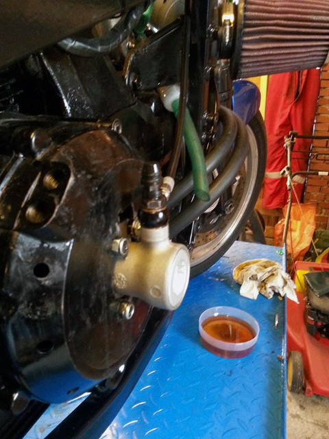

This option was posted on the Paso FB group a while back. Still makes me speechless and I don`t know how that will work with the fairing but I guess it`s one way of fixing it :truck:
