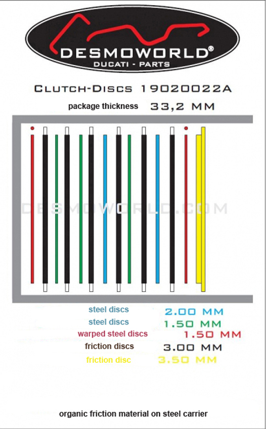

o On the 750 & 906 with the clutch slave piston in the clutch cover a squealing noise when the clutch is disengaged (when engine is running that is) can indicate a defective clutch throw out bearing which is relatively cheap to fix

P750 clutch disc order

Clutch Plate Sequence:
viewtopic.php?t=490
viewtopic.php?t=412
Clutch Plate Pack order number:
190 200 22A (formerly 190 200 21A) or Surflex S2076 (or Surflex S1686 for the sintered clutch pack)
same for : 500 Pantah, 750 F1 -´88 (2.series), Montjuich ´86-´87, Laguna Seca ´87, 750 Sport ´88-´90, 750 SS ´91-´92, 900 SS ´89 -´90, 906 Paso ´89-´90, 750 Paso ´86-´89, 851 SB ´88, 888 Racing ´89
ADIGE clutch kits:
Please note these refer only to the friction pack. For the complete sets the best is to check the catalogue and find out the complete set code# against the friction pack code#.
According to their catalogue the dry clutch kits available are:
DU-45 (Elefant 650, Indiana, F3 , F1 Laguna Seca & Santa Monica)
DU-83 (Elefant 350, 750 Dakar, Explorer, Bifaro, 900)
DU-79 (Sport, Junior, Paso 750 & 906)
DU-56 (all/most of "dry clutch" Ducati from '91 onwards including the Tamburini* series)
DU-74 (851 & 888 and all Tamburini SP, SPS, R)
according to ADIGE:
DU-45 = organic friction Kit discs only (6disc+1 "tornito"** ) Steel disc support
DU-83 = organic friction Kit discs only (7disc+1 "tornito"** ) Steel disc support
DU-79 = same as DU-45
DU-56 = organic friction Kit discs only (7discs) Steel disc support
DU-74 - Syntered friction Kit discs only (8 disc) steel disc support.
*Tamburini = 748-916-996-998 in Strada & S versions
** Tornito = literally means machined on the lathe; I checked a couple of pictures on the web and it seems that these kits have 1 disc which is plain (no friction material)
The complete clutch kit (friction + steel discs) is: DU-81

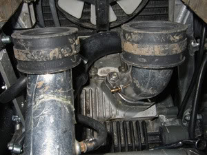

 Post subject: more Mikuni conversion
PostPosted: Mon Jul 17, 2006 7:46 pm
Offline
Posts: 5494
Mikuni conversion
Take the carburettor from a (600)/750/900 Supersport/Monster. They are all the same but with different jetting. If you have a P750/Sport take the carb manifolds of a 750 SS/Monster (not of a 600 as those have a smaller inner diameter). For a 906 take the ones of a 900cc Duc. Their length is minimally different as is their angle (as the cylinders are higher) although they look identical. (Don't listen to anyone who says they are all the same. Some carb manifolds have a 6, 7 or 9 stamped on their flange identifying them as for a 600, 750 or 900 Duc). When mounting the carb manifolds try to swap the vertical and horizontal one if they stand in a different angle.
incorrect
correctly swapped
Furthermore you need the 2 throttle cables & accelerator throttle from a Supersport/Monster, the 2 rubber boots to fit the carb on the carb manifolds, 4 hose clamps, the gaskets below the carb manifolds, two breather canisters, the breather tubes incl. valves and some air filters. You can still use your old choke lever/mechanism but it will need the cable from a SS (or another with a nipple on both ends).
The Mikuni from a Yamaha TDM/TRX can be fitted as well but it is a little different. It has a throttle position sensor (which can be ignored) and is mounted reversed on the Yamahas. So when this carb is put on a Duc the throttle cable connection is on the rear. As a consequence longer throttle cables are needed and the installation is a little more difficult. As the throttle cables from a TRX/TDM don`t combine with the accelerator throttle from a Ducati you will need the complete throttle cables and accelerator throttle from a Yamaha as well. The bent tubes for the breather hose connections show downwards and to the rear on a Duc Mikuni but slightly upwards on a Yamaha Mikuni. These will be in the way if you plan to make an airbox instead of using pod filters. A Mikuni from a Duc is the easier fit.
The advantage of the Yamaha Mikuni is that chances are you find one cheaper and it has a remote idle adjuster as well.
The steps:
What you will need is a spray-can of carb-cleaner. Be sure to have the correct size Phillips screw driver at hand or you will ruin the screw heads! (specially the ones of the float chamber cover). It's highly recommended to remove and note all jet sizes of the carb as you never know if it's being fiddled with in the past. Compare that to the jettings shown on the bottom. You'll need this info as a starting point for an eventual rejetting.
1, Clean the carb. If you don't want to remove the jets spray some carb cleaner in them.
Remove the round cover holding the carb with this side upwards, because on the bottom under the cover there is a very little O-ring, which gets lost very easily. After this gently remove the membrane, the needle and the slider. Clean the slider and needle with a soft cloth and some carb-cleaner and also the plastic part inside the carb where the slider moves in. The slider should move effortlessly.
Do not (!!!) get any carb-cleaner or other solvent on the rubber membrane. It will lose shape and will be very hard to place when reassembling. (if that happened do not dry the membrane by placing it near a heater). If a membrane has a hole in it, it has to be replaced. Replace also if dry and stiff).
On the left above the opening for the slider there`s a very small jet. That's the air jet.
2, Remove the square cover of the float chamber then. Clean it inside. After longer storage of the bike there will be some deposits from dried fuel.
The screws of the cover are often dry and seized so it's crucial you use the correct size Phillips screw driver or you will ruin the screw heads. In case the old screws don`t turn try to tap the Phillips screw driver with a hammer. If you do ruin them or they already are, replace them with allen screws. (Applying a little bit of anti seize paste will help in future)
The big slotted jet is the starter jet which holds the main jet in place. Deep in the hole next to these two is the idle jet.
If you remove the hex screw you can pull off the whole part with the jets and push out the needle valve which including the white plastic part will come out on the opposite side.
3, In case you fully want to disassemble the Mikunis (which is easy) be careful when removing the plastic actuators of the choke assembly. These are held by 2 clips that have to be pressed together while carefully pulling the actuators out. If you're unsure leave them alone as it's possible one of the plastic retaining clips breaks off. In case you do remove them note which way round they are mounted (there`s a small metal shield on one side of the needle)
4, On the bottom middle of the float chambers are the pilot screws (idle adjustment). It's possible these are sealed. If so very carefully (!) drill out the plug with a 5/32 (3,5-4mm) drill so you can adjust them. If the adjuster screws were not sealed remove them to check if the washer and o-ring are there. (the order from inside to out is rubber o-ring, washer, spring, adjuster screw). Note the o-ring and washer are extremely small so work on a clean table, preferably put a towel on it as parts falling down won`t bounce from the table as they would from a hard surface.
For a basic set up turn the screws in clockwise until lightly (!!!) seated, then back out 2,5 or 3 turns. Turning the screw clockwise (in) will reduce the added air/fuel mixture, counterclockwise (out) will add more.
Making a small indication mark when the screws are fully in may help when counting turns.
To keep the adjuster screws from seizing find two matching plastic caps or a rubber tube that fits over the ducts. In case of a rubber tube heat one end until it starts to melt and squash with flat pliers.
5, Do not oil the choke slider on the back part of the carb as this will attract dust & dirt. Try to keep it clean same as the throttle rocker.
6, The 2-cable accelerator throttle is a must. Do not use a one cable unit, the closer cable is there for a reason. Btw there should be only little "play" in the accelerator throttle (ca. 3mm).
7, Between the accelerator throttle and the rubber grip there's a plastic washer to prevent the rubber grip to touch the accelerator throttle housing.
8, Oil the throttle cables before assembling everything. It will be hard afterwards.
The throttle cables lead trough the triangle (front-frame) to the carb. The upper cable of the accelerator throttle connects to the lower of the throttle rocker of the carb (throttle opener).
9, Check how well the paper gaskets match the carb manifold and cylinder head port diameter. If you don`t have original gaskets get or make some. Oil the gaskets when mounting them
10, Small air filters are no good. Prefer higher ones if possible. I.e. UNI filter UP4060A (10cm height), better UNI filter UP6060A (15cm) or K&N SN-2530
11, When connecting the choke cable be sure it still has a little slack when the choke lever is in OFF position
12, the fuel-lines: if you have an aftermarket fuel-pressure regulator remove it (it's not required). On the Mikuni there are 2 (movable) "T" pieces. The front (lower) one with a small filter inside is the fuel inlet coming from the fuel-pump. In this fuel-line (before the carb) there must be a "Y" piece leading excessive fuel back to the tank (rear connection pipe of the tank, the one before it is the tank breather). It must be there or the carb could flood. (and give Weber-like symptoms). If there`s a restrictor jet in the Y piece or return line remove it.
The rear (higher) "T" is an output which leads to a little fuel resistant plastic canister attached to the frame (left side).
Each carb body has a downwards bend tube on the right upper side. This is the connection for the breather hose with the small black filters. These hoses lead to a plastic canister (attached to frame - right side). The only reason for these canisters is that the breather and overflow hoses end in a windless environment. The breather connection allows the diaphragm to move. Air is sucked in and pushed out depending on the movement of the diaphragm. To hinder dust to enter you need those black inline filters and to not influence the movement of the membrane by underpressure on the breather connection the breather hose leads to the small canister.
When it comes to which canisters you use, you can either improvise with some small plastic bottles, take the larger triangle shaped ones from a Supersport or the smaller, flat ones from a Monster.
The latter are easier to find a place for. (If you mount them on a frame rail, place them on the frame and mark inner and outer edge of the frame rail on the canister. Then drill 4 holes in the canister to fit them to the frame with cable ties. Use long cable ties and bend them before trying to fiddle them through the holes. Put some textile tape on the frame where the cable ties will be to prevent any rubbing).
On the front (lower part float chamber) there are two outputs. The one next to a screw is the float chamber drain. This usually connects to a thin tube that leads down the frame towards the ground.
13, The Mikuni will work with the electric fuel pump but imo the underpressure fuel pump as used on the Monster or TDM/TRX is the better match
viewtopic.php?f=2&t=6800
14, Don`t forget to block the hose nipples on the carb manifolds which are not used. Replace them by a screw and gasket. If you have a 906 don`t forget to connect the vacuum tube for the ignition advance that connects to the Marelli Digiplex.
Depending of the model the carb manifolds came from there may be no screw nipples, not even holes for them. In that case you have to drill the holes and cut the threads by yourself. (the original hose nipples have a M5 thread) Hose can be found at Ducati, http://www.motionpro.com or in shops for model making (radio controlled cars/ planes) or hydraulics
15, When you fire up the engine the first time you may need carb-cleaner/ starting aid spray. Use only a little as it washes the oil from the cylinder walls, too. Try starting w/o using choke and with the air filters mounted. Don`t let the engine turn over endlessly. If it doesn`t fire up wait a while and try again, after all the fuel needs to get pumped to the carb and the air needs to get out of the system.
You`re also likely to flood the engine at the first start up so go slow.
The engine may run bad the first time. Let it run a bit and see if it gets better when the engine gets warmer. Adjust idle and balance the carb. Later on correct the jetting as necessary (the stock SS/Monster jetting will probably not match perfectly with pod filters and maybe even an aftermarket exhaust)
If you let the engine run in the garage open all doors ! A fan placed in front of the bike may help preventing it to overheat.
16, Use clean spark plugs. Champions seem to work better than others (RA6HC for the 750, RA8HC for the 906). Gap = 0,6 mm
17, In case you'll use a modified air box you can fit a K&N DU-0900 air filter
18, You can use a Dynojet stage 1 or 2 kit from Micron (for SS or Monster) to improve performance. Specially recommended if using an aftermarket exhaust system.
This should work better than the original SS setup, but still it's highly recommended to dynorun the bike after the conversion and have the carb adjusted and jetted individually specially if you`re using pod filters and an aftermarket exhaust. (Don`t expect the bike to run perfect with the original SS jetting and that - much leaner - setup).
I didn't do this as the bike ran fine with the Dynojet kit (using a custom airbox, not pod filters), but that doesn't mean it could've worked even better.
Do check this thread: viewtopic.php?f=2&t=6403
