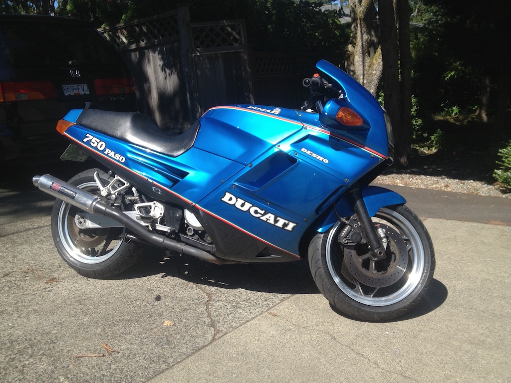

I have an 88 Blue North American Market Paso that was running and wonderful until my chain snapped and cracked my engine case. I love the bike, but I'm not sure what to do with it. the tire problem and the availability of parts makes this bike hard to keep on the road. it will never be a museum piece, but it looks great, was in fantastic running order, and was my first motorcycle which was gifted to me by my father (pasophisto).
It has the upgraded ignition system, the upgraded twin intake manifolds with Dellorto carbs and stainless reusable K&N filters, period correct Yoshimura stainless exhaust, the engine had a full valve adjustment 50 kms before the chain let go.
every once in a while I see 750 Pantah engines for sale, but they are costly (especially to ship) and I'm not sure its the route I want to go. I have tons of parts for the machine that could help with a package deal sale to avoid parting it out. But parting it out is also another option. I guess maybe the best financial decision is to replace the motor, then sell it as a working bike, but then it has a non original motor and worth even less?
On the bike:
-NEW golden tyres in original 16' spec (500 km tops on them)
-14 tooth front sprocket
-replacement OEM rear shock
-replacement voltage regulator
-stainless braided front brake lines
-fully functioning dashboard
-rebuilt starter motor
-new battery
-CORBIN seat
Other parts:
-spare right +left OEM front fairings (body colour)
-spare right +left OEM rad covers (body colour)
-spare right +left rad covers (unpainted)
-original rear shock
-spare brake rotors
-2 complete sets of old tires
-1 front tire mounted on a spare front wheel
-rear swingarm (complete with bearings and axle)
-spare right +left oil rads
-some electrical (voltage regulator, and other misc things)
-original 15 tooth front sprocket
-spare dashboard
what are your guys' thoughts on my situation?
what is all this stuff worth?
is anyone interested in what I have?
ready...set....GO!!!

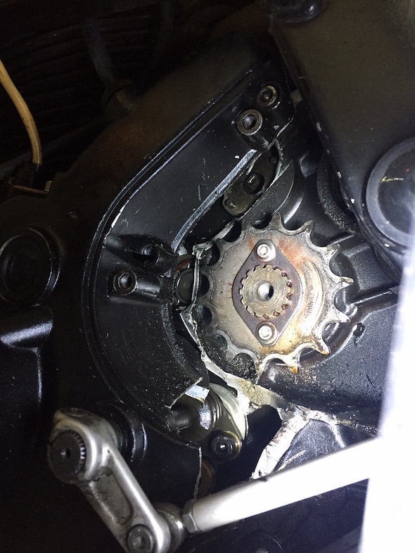

Is your output shaft loose compared to the cases? Can you take a photo so we can help you assess the extent of the damage? If you can even JB weld up the cases enough for a test drive, you will get more money for the bike.
In the condition its in, not running, you might get $800. If someone can at least test drive it to confirm everything else, you might get $1500 - $2k. Of course you should disclose the chain mishap and the broken cases. Let the new owner decide how to fix it.

this is the damage to the engine. there is no reason for me to believe that there is damage or play regarding the output shaft, everything was groovy and tight until the chain flung forwards, I turned the engine off right away as the oil poured out, and haven't turned it over since. SO what is broken is.. the left outer cover, and the case. JB Weld isn't fixing this one unfortunately
 Post subject: Re: Beautiful Paso with a broken engine case... what do I do
PostPosted: Fri Feb 12, 2016 1:35 am
Yeah, that would take more than 2 tubes. :-P :shock:
The outer case is easier to find than the center case, and those are matched when they make them, so getting only one side isn't a good idea.
Finding a spare engine is your best bet. Since a Paso motor fits only a Paso, it will be either really cheap, or really expensive. Limited supply, but also very limited demand.

There was a P750 that had a Monster 750 motor fitted into the frame a while back. This could also be an option, as the Monster motor would be a bit easier to source.
Update the motor (and carby's, or even fuel injection!?), dismantle the old and part out anything of value and away you go on a Paso on the outside with a slightly modern motor on the inside.

Find a new motor/ cases - you only need the case and keep it - they don't make 'em like they used to !
PostPosted: Fri Feb 12, 2016 10:56 am
That is well beyond JB Weld however will do it
so will DEVCON which is a 2 part epoxy you add aluminium filings too, very strong easier to use than Alumiweld and is completely machinable once cured. I have used it in the past to enlarge the transfer ports on 2 stroke engines and it has lasted for 20 years soaked in oil and under constant vibration

That is fixable, it will take some work and a good welder, but I have seen worse damage repaired.
if it was my bike I would not think twice, I would fix it.
One option is to repair your engine, the other is to get a set of cases from fleabay and fill them with you engine parts.
Third option is to get an egine from a donor bike, even counting shipping it might not be that expensive.
