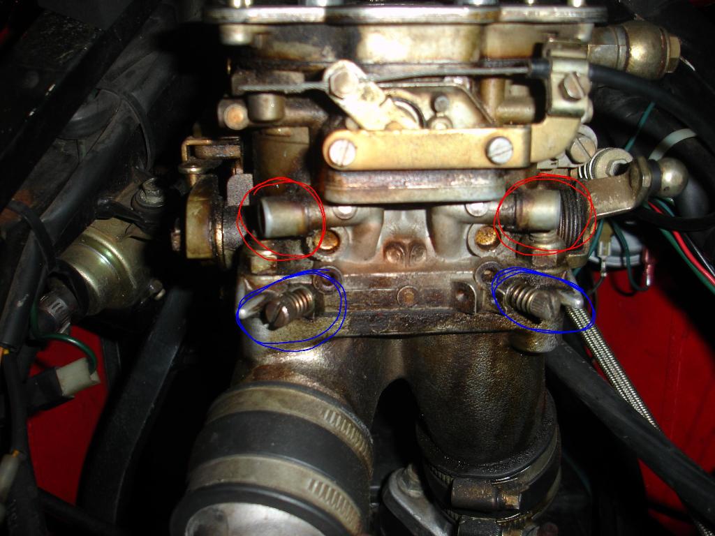

Hopefully the attached image is visible - the screws circled in blue are the idle mixture screws, the areas circled in red are the idle air bypass screw housings (screws are recessed within).
Hope that helps!
Start with both bypass screws closed, and the mixture screws about 2.5 turns out. Get the engine started, if it won't idle, first open both mixture screws about 0.5 turns from initial setting, then try closing both mixture screws about 0.5 turns from original setting. Once you get the engine idling, slowly adjust one mixture screw at a time to get the highest idle rpm you can, then adjust the other mixture screw in the same way. Final adjustment is setting the idle speed screw to get about 1000 rpm idle speed.
