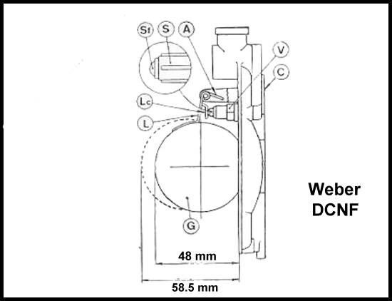

Any advise on which float level I should use: 42 or 46mm?

generally speaking the float level when adjusted correctly should be level with the carb top when the needle just contacts the seat. My eyes are older these days and I find a cheap pair of diopters(reading glasses) from the local drug shop most helpful in seeing when the spring on the top of the needle just starts to compress. This is the point where the top of the float should be level with the carb top.

Higgy, thanks I'll adjust the float to be level with the top of the carb.
Makes sence because if not level my next question would be which part of the float should be 46mm from the top.
If I adjust it level with the top it measures 42mm, so I will keep it there.
