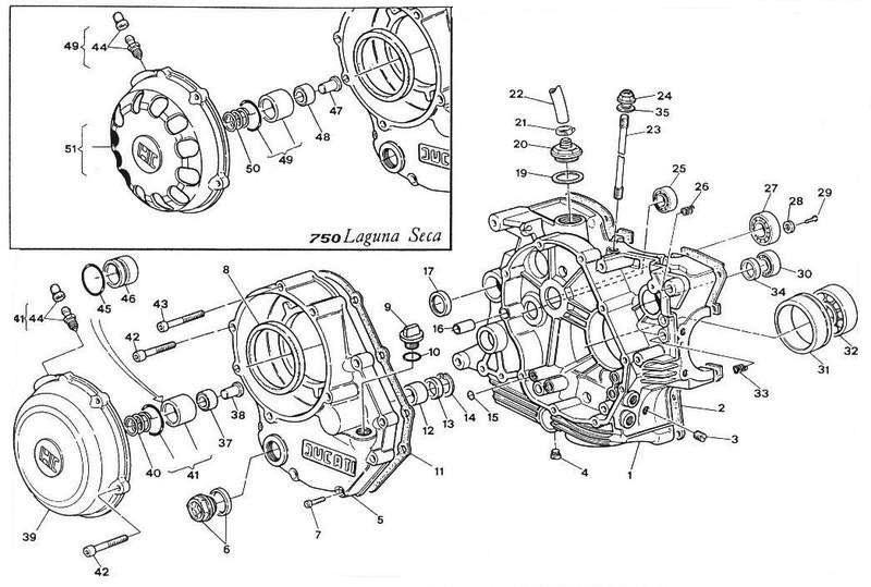

Is that good news?! Have you tried to find a F1 slave cylinder? :dunno: What`s the diameter, did you remove it and if so could you post pictures?
According to the F1 parts catalogues there were three clutch slave pistons.
067516450 31mm diameter and no o-ring groove as that's in the cylinder (part not available anymore) #41
067016460 31mm diameter with o-ring groove (part not available anymore) #46
066516450 28mm no o-ring groove (Laguna Seca/same as on 85 Alazzurra 650) #49
I really hope your slave piston is not the big one.

26mm diameter piston, ventilated Paso clutch cover by Nichols. Piston,bearing sleeve and mushroom pin all stuck together (#46, #37, #36 on Table 10 of the parts catalog). Any suggestions on how to get them apart? I am such a novice that I don't really understand what failed. Perhaps because they are the parts are somewhat fused together? There was no loss of clutch fluid before I drained the system to remove the piston. Thank you all for the kindly assistance. Thanks and praises!
