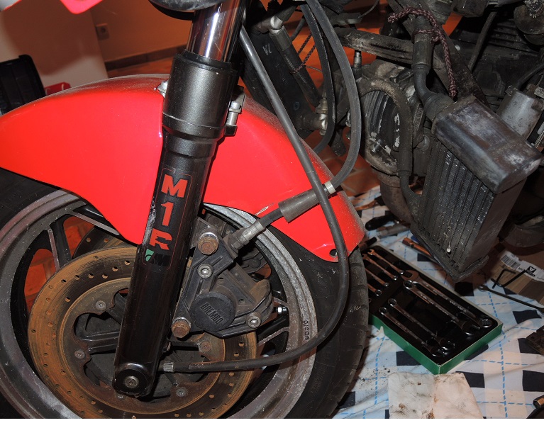

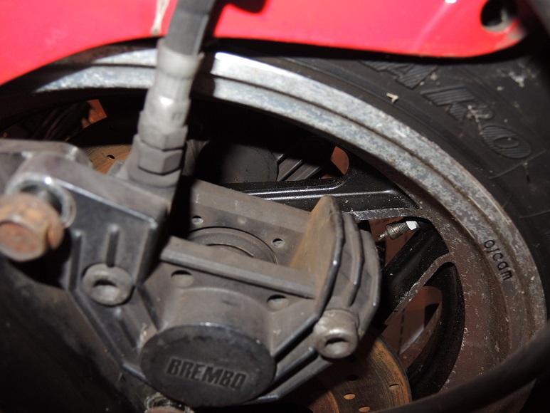

My Paso’s wheels were suffering the typical problems which I’ve seen often on our beloved bikes: oxidation and blistering clear lacquer.
The metallic black paint on the hub and spokes seems to be more durable, at least in my case. Another thing that irritated me was a flaw
dent in my front rim.

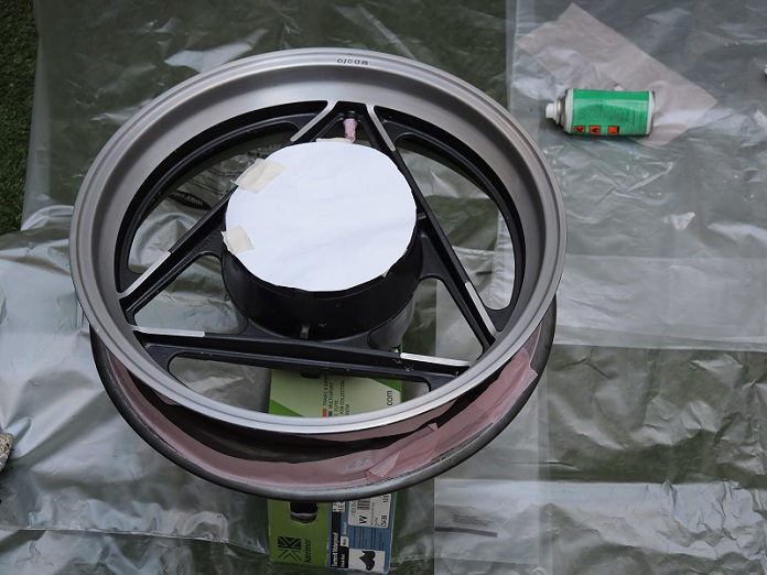

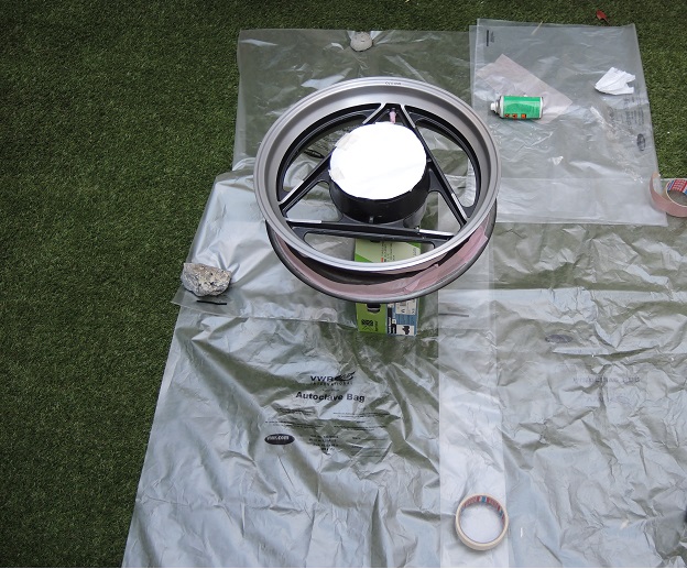

- Position the rim so that you can easily spray paint it. I put it on a shoe box. As I did not paint the inside of the rim (where the tyre is mounted) I
could easily turn the wheel around and paint the other side.
Step 4: Spray paint

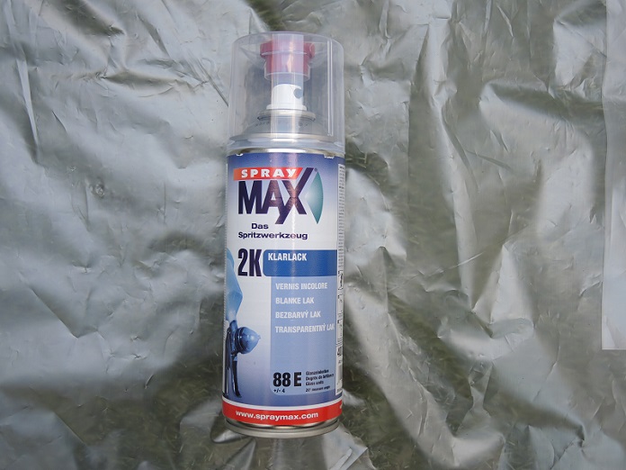

- 2K clear lacquer in a spray can: Spraymax 2K Klarlack http://www.spraymax.com
This product was quite a revelation to me. A two component product in a spray can, so easy to apply and not expensive (around EUR 20,- for a 400
ml spray can, which if you take care is enough for both wheels). Further, after curing the layer gets very hard, which is perfect for rims of course.
- Prepare the spray can by adding the hardener to the paint (see instructions on the spray can). You must use the lacquer within a restricted time as
the curing process will start immediately (If I remember well, within 48 hours)
- Spray a few thin layers after each other, leaving each dry for 10 or 20 minutes in between. Be careful, don’t apply too much paint as what comes
out of the spray can is quite thick! Further, this product really stinks, so use a proper respirator.

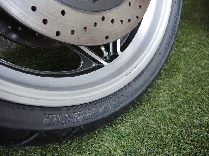

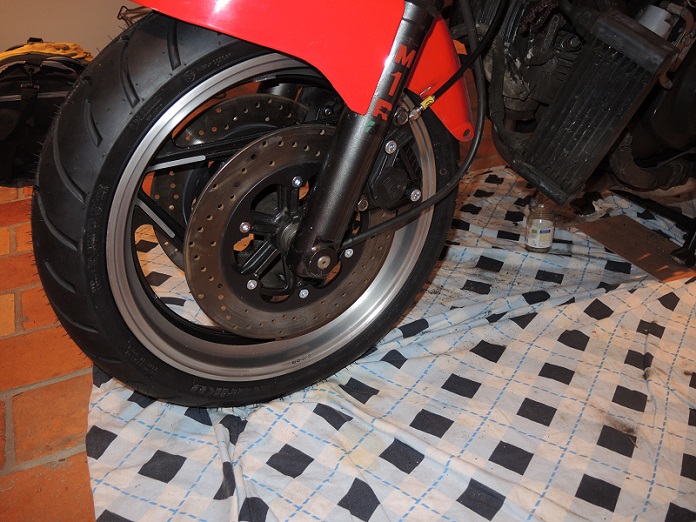

Result: see pictures below! :lol:

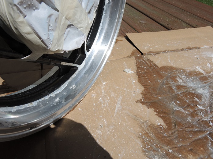

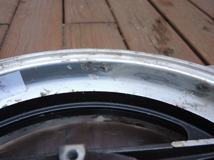

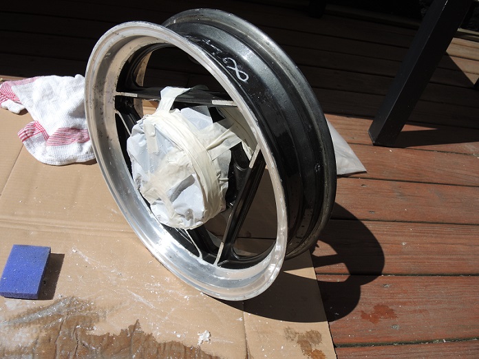

File comment: Paint stripping in progress

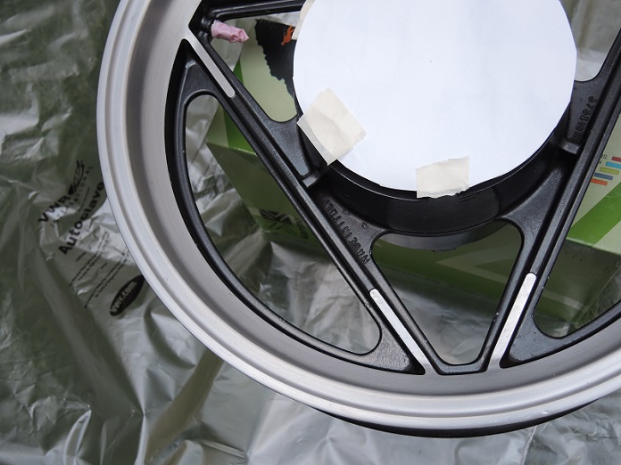

And some more pics of the painting process

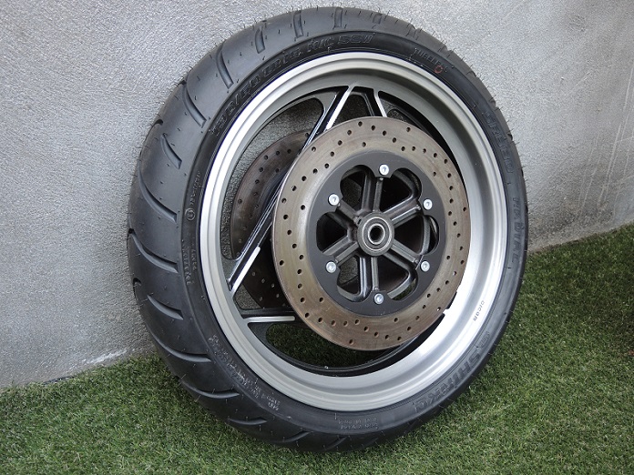

Final result
