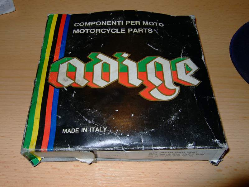

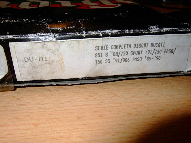

I found the box of the Adige kit I bought back in 2001 :)

I think the DU-81 is the complete set including the steel dics
