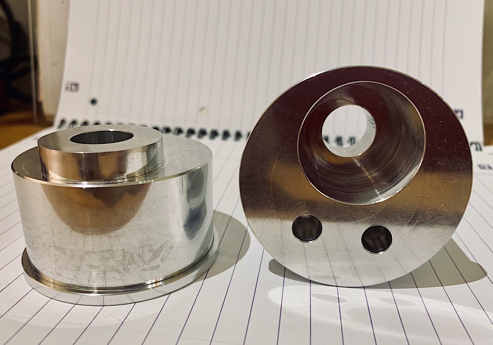

Another option would be to get new swingarm excenters machined so a 17mm axle can be fitted. This will avoid numerous issues. You can find the drawing in the downloads thread on top of the P750 forum.

Hi
I went with new chain adjusters machined to take 17mm spindle...collected today!
