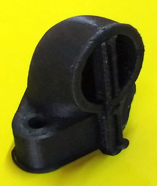

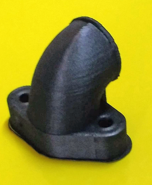

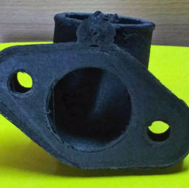

Ok guys, take some time to read as I'm going to tell ou about a quite llong winter project. Everything begun when I happened to get a pair of 36 dell'orto carbs from an Elefant 650

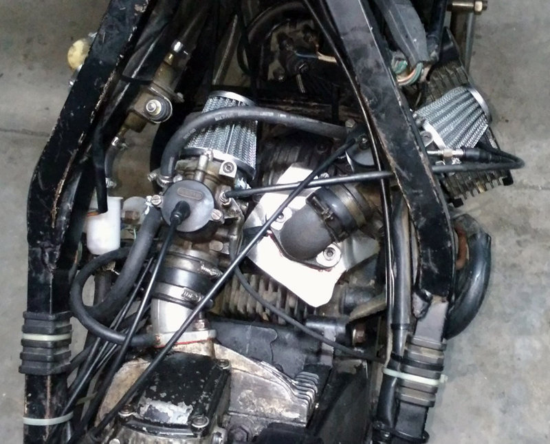

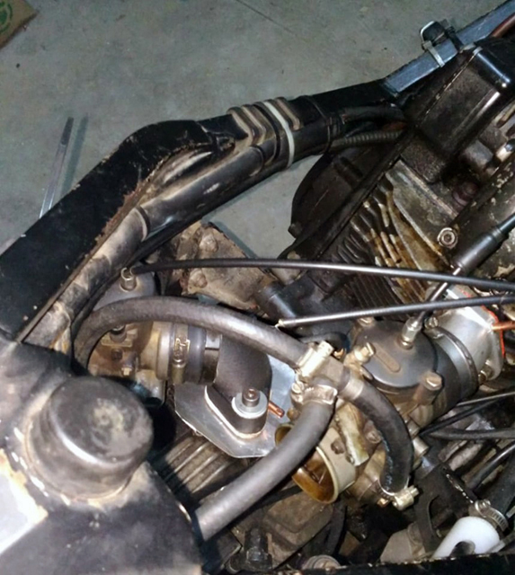

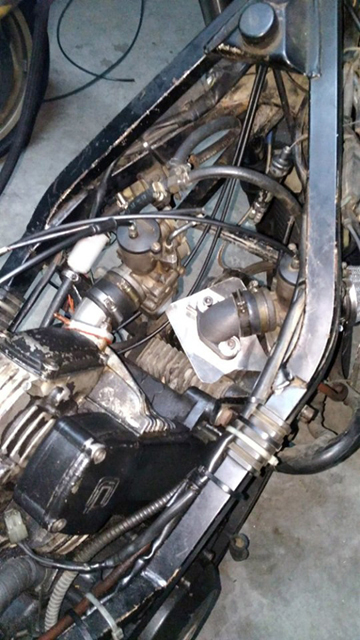

OEM mainfolds were badly damaged, rubber collars were wornand they were impossible to fix. So I tried to rebuild them in fiberglass and epoxy resin, but this couldn't face heat from engine and I kept on searching for a better material. I meant to rotate the carburetteur on the orizontal cylinder frontward so I designed it on a 3d software and I printed it on polyamide 12 and carbon fiber, good for 160 °C (320 °F) and strong enough to resist to the pantah vibrations :-)
The conversion required also Tommaselli twin wire throttle and soft springs for carbs: this (and quite an amount of grease) made the handle soft enough to ride confortably. Two main jets 150 were needed too.
