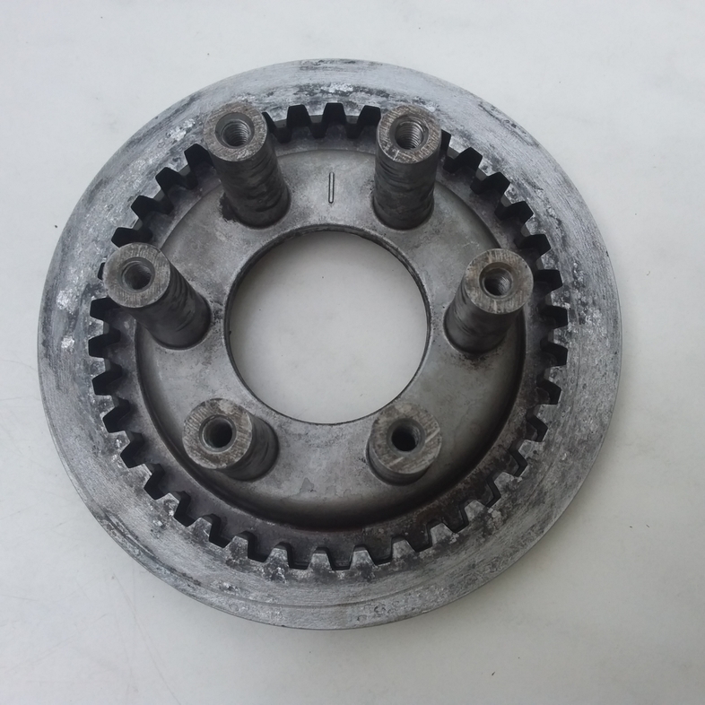

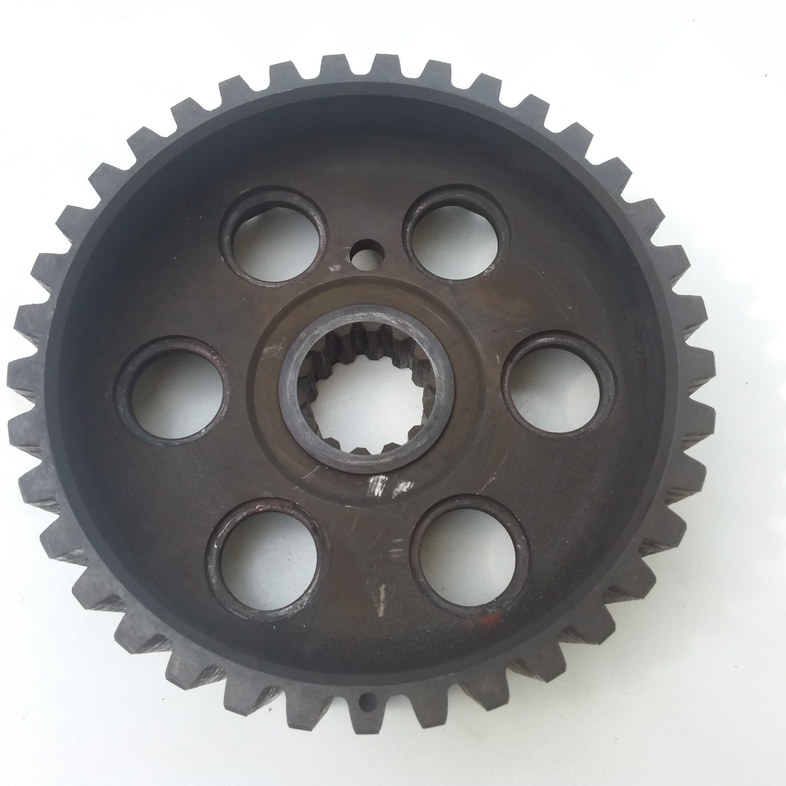

3) I see markings on the clutch pressure plate (a "I") and the clutch hub (a small hole in the middle of the hub), I assume (again :-P ) that the hole and the "I" should be mounted right across from each other, since only then the holes and the aluminium protrusions (sorry, couldn't find a correct name for them) are perfectly centered.
The only remaining issue regarding positioning (rotation) is: where should the recess of the steel clutch plates point to ….. :smoke:
Or is the positioning of the recess of the steel plates a non-issue (I hope)?
Ducati Paso 750 - clutch pressure plate - 786x786.jpg [ 349.97 KiB | Viewed 48453 times ]

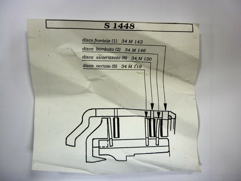

After sending some emails to Surflex and Adige/Adler (the 2 main clutch plate suppliers of the Paso) and Googling some more, I found the following cross section drawing (Surflex S1448).
This shows, in my view, clearly and correctly the positions of and the way how to mount the clutch steel/friction plates in the Paso 750/906.
So convex 1st and last. :!:
The strangest thing for me is that both suppliers do not mention anything about the differences in thickness of the steel plates (3 pcs. of 1.5mm & 2 pcs. of 2.0mm) but for me that is of minor importance.
I assume (there I go again ;) ) that these differences in thickness are for making the stack thickness of the clutch plates appropriate and that the precise placement/position of these steel plates is of secondary importance.
Gerhard, I will sent you a PDF (better quality) in an email of this Surflex S1448 kit.
So Gerhard, could you be so kind to put the documentation away in the right place (as you always do dutifully :thumbup: )?
Again perhaps unnecessarily: there are many clutch kits for the Paso750/906 and this drawing of course applies to all kits, not just the Surflex. :banghead:
If I would receive further information from (Adler/Adige) I will keep you informed.
Still I do not understand why in the original Paso 750 workshop manual the min. thickness of the friction clutch plate is 3.3mm but I assume that in the past this was applicable for the Pantah 500/600/650 and in the hurry (hey, it was Ducati at it's most vulnerable period in it's history) this is overlooked and later in the Paso 906 workshop manual been adjusted to 2.8mm.
Well, for me that leaves the position (rotation) of the steel plates with their recess/cutout.
To be honest, I think it's it is hardly relevant and for me I mount them directly opposite the hole in the hub (so where in the hub there is a mark with a dot).
If there is anyone who wants to comment on this clutch plate thread, feel free. :beer:
File comment: cross section drawing clutch plate position 750/906

No E, I'm happy that you did give me that thread, made once more clear that there are a lot of ideas how-to but not 1 clear answer to the question: how to correctly mount the clutch plates in a Paso (more like: tick a pick).
In the end I managed to find the final (does such a thing actually exist for a Ducati? :lol: ) mounting method.
What also helped was the fact that what surflex described/drew in it's overview did not correspond with the clutch construction of the Paso and also a loose spring, which according the Surflex drawing should be present (so a convex one with both small inner and outer diameter with no "teeth") I have never saw that in a clutch set of a Paso (750/906).
Only after they told me to look at the drawing of their S1448 kit it was clear to me.
So, happy to have solved it.
Just crazy that in the original workshop manual this is not described/pictured in detail (just: "in the correct order" :banghead: ).
Also the Haynes manual didn't mention this in detail (although they were more focussed on the later versions with the clutch slave on the left side).
Well, I printed the drawing and have put it in the workshop manual with adhesive tape.

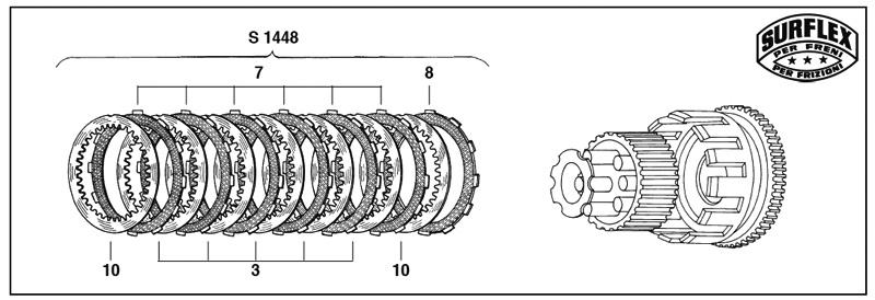

I never understood the Surflex catalog for multiple reasons. If you compare the parts numbers in the P750 and 750S parts catalog from clutch basket, core, discs to springs all parts on both have identical part numbers. However the 750 Sport parts catalog mentions 2 steel disc thicknesses. There’re part numbers for 1,5 and 2mm steel discs but the 2mm has no number and does not appear in the exploded parts overview.
The 750S parts catalog lists #19020021A for the complete clutch disc pack, there’s nothing mentioned for the P750. If you check Stein Dinse you find that #19020021A (and 066516690) has become #19020022A which is supposed to fit not only the Sport and Paso but also the 907IE (which seems odd but that’s a different story).
Still Surflex lists different clutch kits. For the Sport only the sintered S 1448 and for the Paso the organic compound S 2076 and the sintered S 1686. (based on the catalogs available on their website)
In the past I’ve bought original car parts from an Audi dealership that had a completely revised design so I can accept that for the P750 there’s a clutch kit with a different setup than what came from factory.
This is the first time I see the S1448 kit listed also for the P750. I find it interesting that now the Sport isn’t listed anymore. Makes you wonder which kit is now the ‘correct’ one for it.
The two pictures posted above don’t match. In the technical drawing the spring discs are on each end of the pack. In the picture above it the second disc is in the middle which is actually the same as shown in the P750 parts catalog. The picture on the bottom of this post shows the S 1448 in reversed order while pictures of other clutch sets are correct… :truck: Surflex's info is not very consistent.
