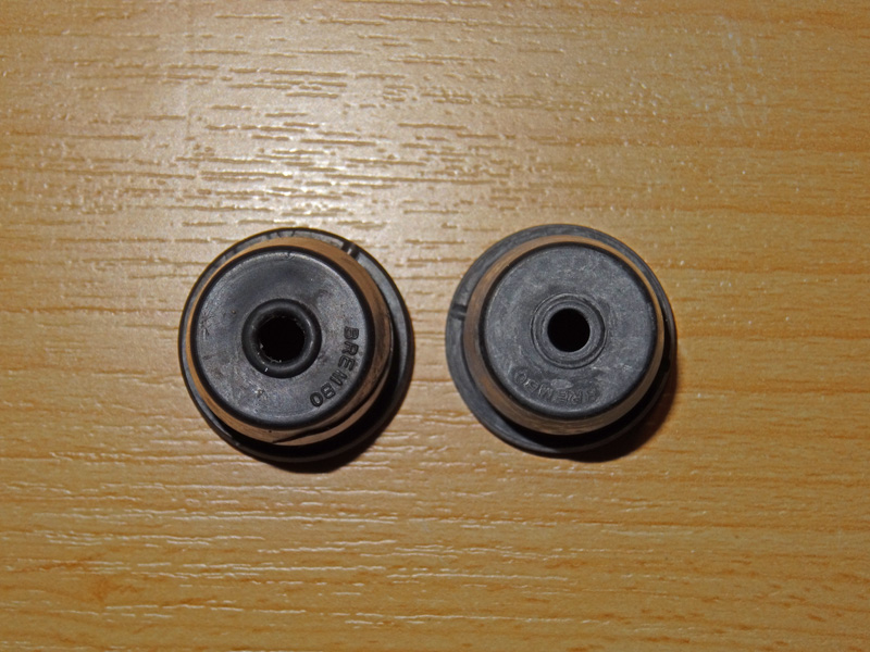

Are the 2 rubber dust boots (clutch and brake side) the same?

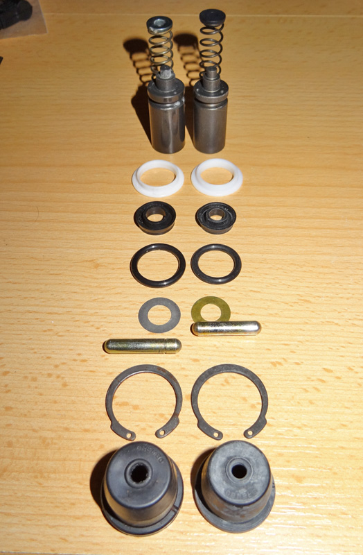

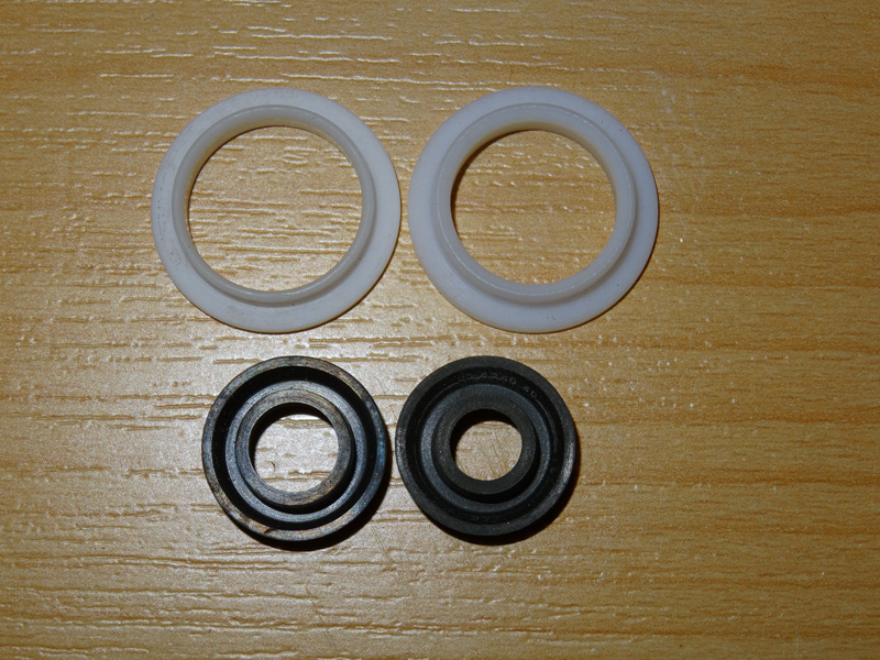

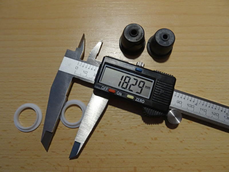

Frank, here're the used parts of the PS16 on the left vs. the new PS15 parts on the right.
The outer diameter of the white plastic rings is the same as is the outer diameter of the edge where the rubber boot sits. So I'm lucky and the rubber boot of the PS15 kit will fit in the PS16 m/c. The rubber boot of the PS13 rep.kit won't fit. It is smaller.
I wonder about the longer spring in the PS15 kit. The length of both pistons is identical. Maybe the depth of the cylinders isn't. I doubt the used spring set so much.

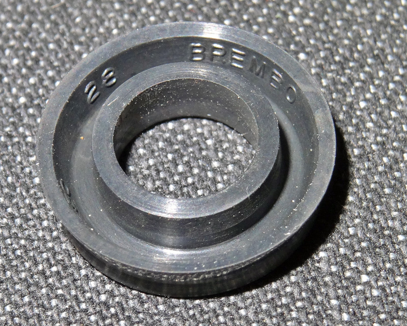

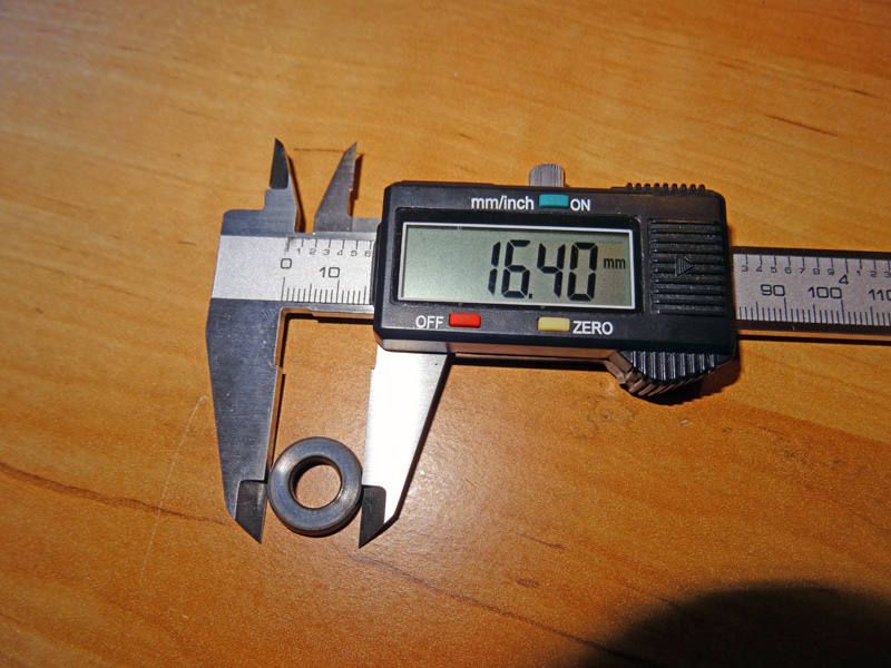

So, if you could measure up the 16mm brake fluid seal (and maybe the 15mm aswell), ID,OD & width we could see if we can find an acceptable substitute if needed in the future ….
Just to bad that the dust seals are not sold separately (as do the radial & semiradial masters from Brembo).
The spring is hardly significant in m.h.o. it will give a little more preload but the force is not substantial compared to the applied braking force (full pull that is).

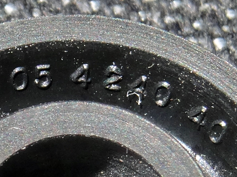

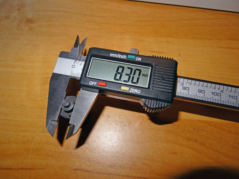

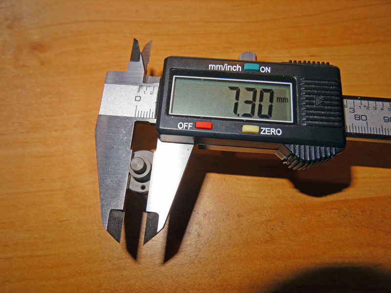

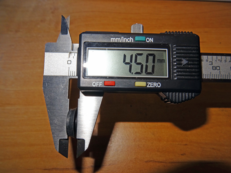

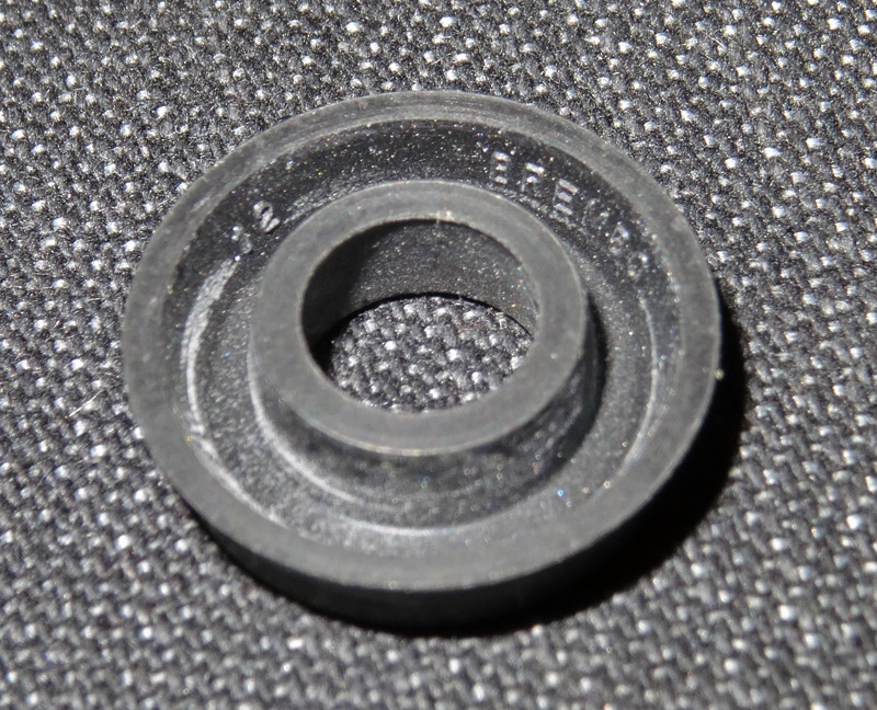

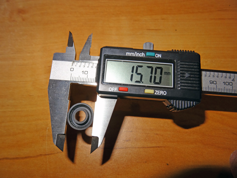

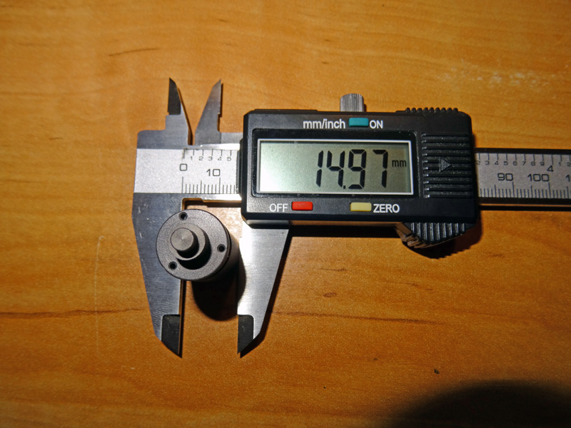

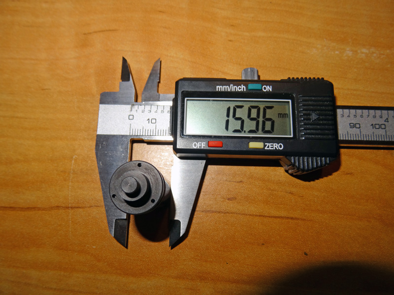

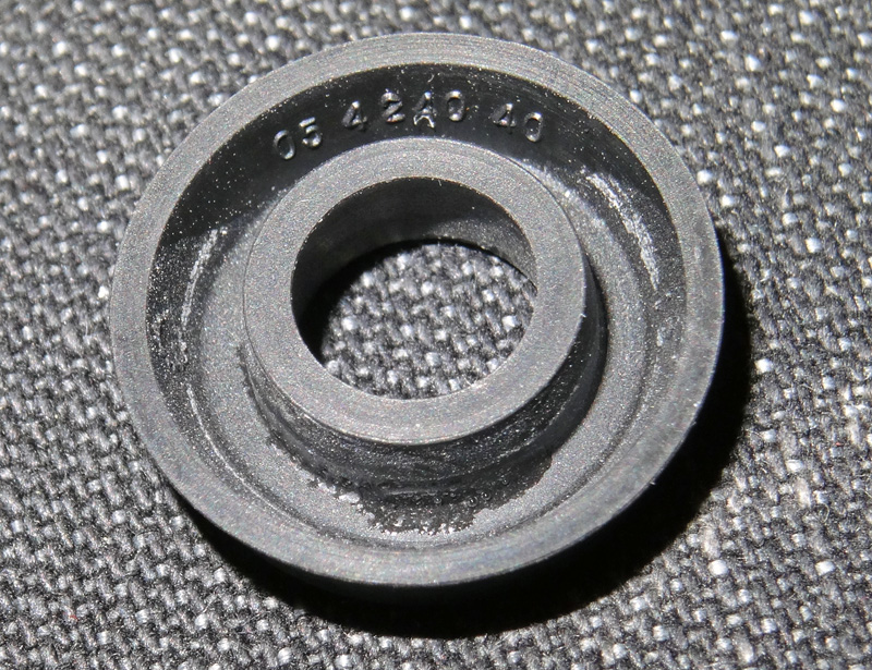

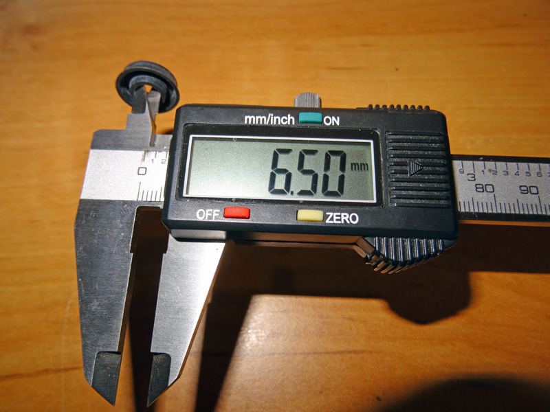

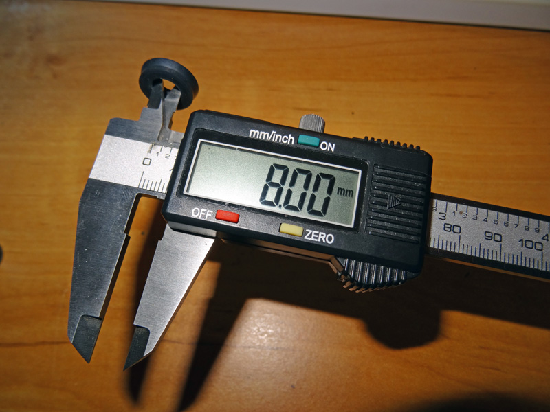

PS15
Dimensions of the seal:
Height: 4,5mm
Inner diameter: 6,5mm (Diameter of the piston where the seal sits: 7,3mm)
Outer diameter: 15,7mm (Diameter of the piston 14,97mm)
#05424040

PostPosted: Fri Jun 05, 2020 12:13 pm

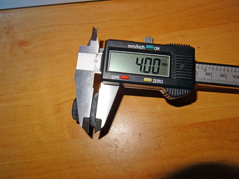

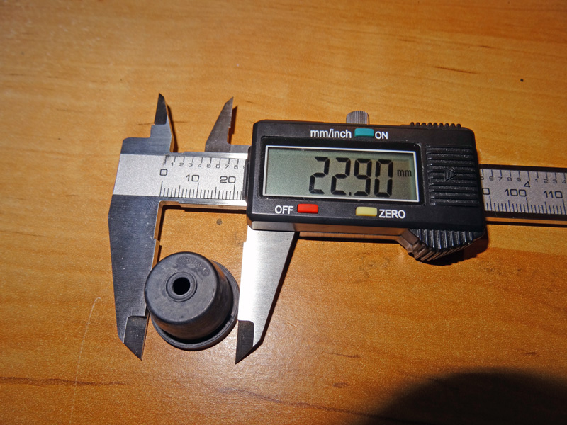

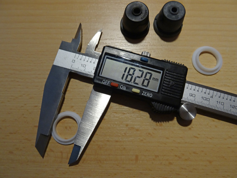

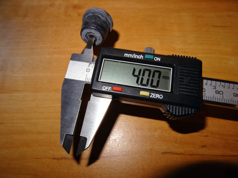

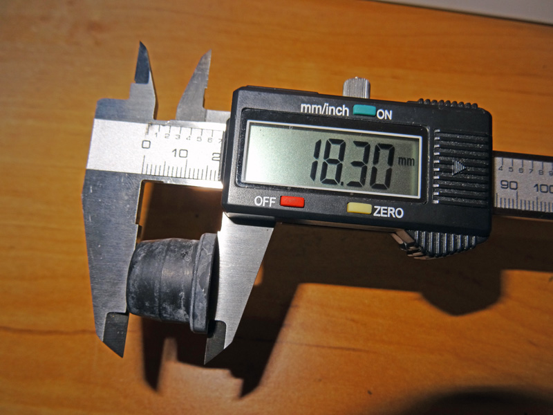

PS15/16 rubber dust boot
Dimensions of the rubber dust boot:
Hole on the top: 4mm (diameter of the actuator pin: 4,97mm)
Bottom (outer) diameter: 22,9mm
Height: 18,3mm
Height of the bottom lip: 4mm
Thickness of the bottom lip: 2,5mm
