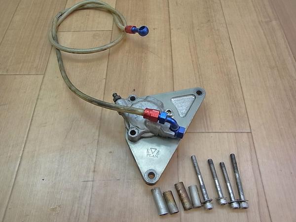

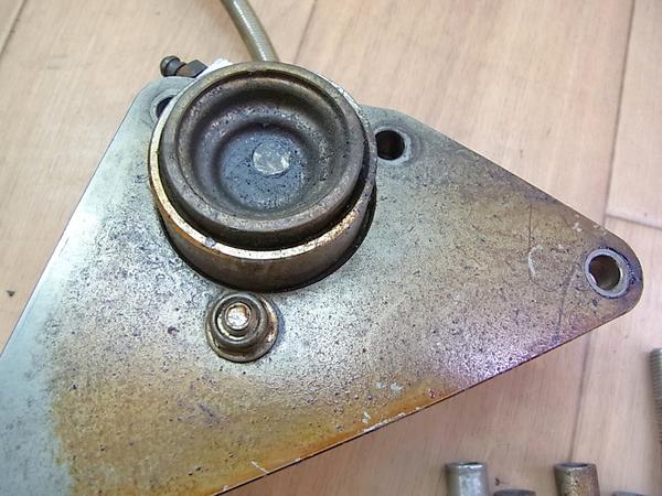

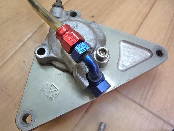

does it looks somewhat like this ? I found this on a japanese website. Someone made it for an early 900SS. I`ve never seen anything like it :)

The slave is similar, but in an open clutch cover. The slave is held in place with a stainless steel basket. Sorry I haven't put any pictures on, I've had some other things to sort, new exhaust, idle screw seized and broken vacuum gages to fix so I can finish setting my carbs up now the bikes done a hundred miles(been off the road since 2002). I will try during the week, I need to paint the slave, might go for gold as I have some paint, red pressure plate and new stainless spring/bolts. I'm going to polish the cover, job for next week!!

I just saw a similar one to that yesterday. Went to buy a headlight :D off a guy who has set up a 900 for period racing and he had purchased 2 bikes from Japan, one being a basket case. It had a similar design to that. Slightly different slave and a bigger plate that covered 4 of the cover mounting holes. Not nicely machined like that one but just a home made 10 or 12mm plate with a couple of speed holes just to pretty it up a little.
Makes me wonder if it comes to that in the future that this mod could look nicely executed if you used a round plate covering the case properly and then get some nice hole patterns machined into it for the ventilation/cooling. By that I mean just for the cool factor and sound.
Although with the availability of the later pistons still I don't really see this as a necessary path unless we run out of covers because they have been down the road. If cylinder bores wear they can be stainless sleeved so as long as the pistons and orings are available there seems no real need other than to be different, not that there is anything wrong with that.
