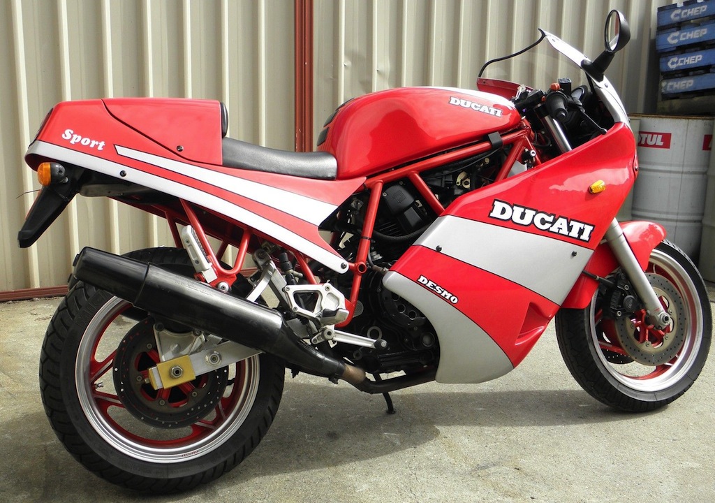

Hello,
After many years of lusting for a 750 Sport, I finally purchased one a few days ago. I'd like to spend some time going through it all and getting everything just right.
It's been delivered with new belts, motor oil and Michiko tyres. I've already replaced the fuel lines and looking to flush the brake and clutch fluids. I've noticed a squeaking sound from the clutch at idle while in neutral. The sound disappears when the clutch is dis engaged. Any ideas?
It's an original bike including webbers, pipes etc.
Thanks
D

Hi and Welcome D.
I've heard and seen this particular bike running in the flesh so to speak, and it was making all the normal engine and dry clutch noise's you would expect, you just hear a bit more with the drilled clutch cover, it's nothing to be overly concerned with, and that is normal when the clutch is pulled in.
Peter
Also please don't forget to make use of the search function on this site, if you haven't already, there is everything you need in the way of literature, manuals, owners books, and advice in various threads.
I was sorely tempted to buy that one myself but had already committed to something else. :thumbup:

Hi Peter,
Thats good to hear and Bruce was a pleasure to deal with too. I've already downloaded the manual and been through quite a few posts…..great site!
This is my first belt drive so I'm getting up to speed and looking forward to knowing the bike better.
I inspected under the seat this morning and found the original tool kit and jets which were updated at some point.
Overall I'm impressed with the condition of this bike, very happy.
