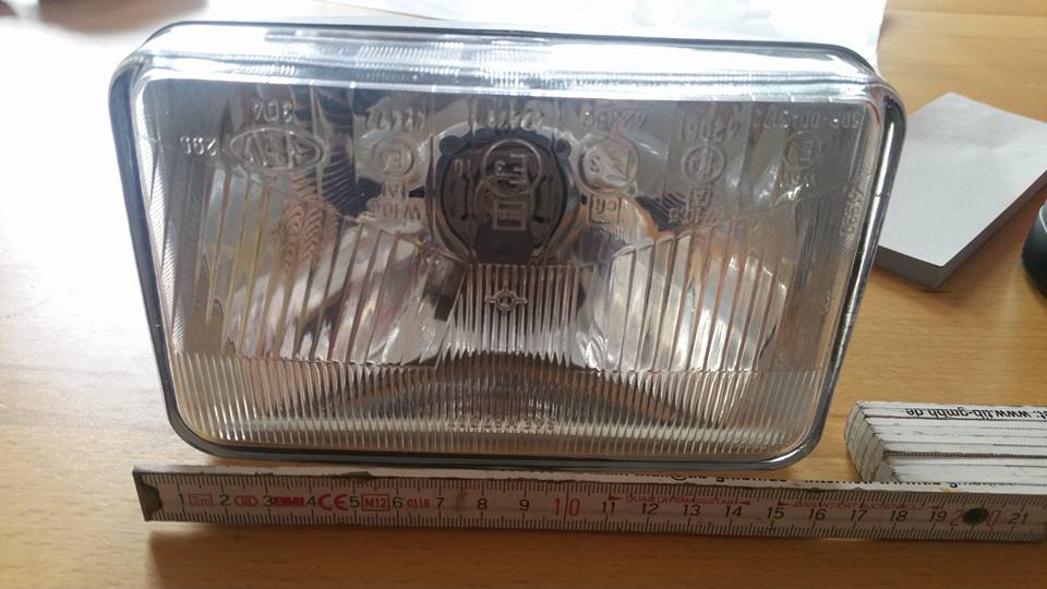

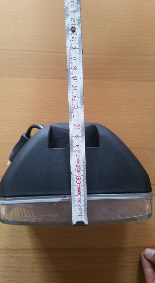

who can check the dimensions of the headlight lens and overall depth of the headlight?
If you google "square headlight" you find some like this one:
http://www.treatland.tv/black-GUIA-squa ... ht-186.htm
I`m sure there`re others with UK spec that could be adapted but it would be important to know the dimensions to compare i.e. with:
http://www.ebay.co.uk/sch/i.html?_from= ... t&_sacat=0
http://www.mftractorspares.co.uk/massey ... 75-1693943

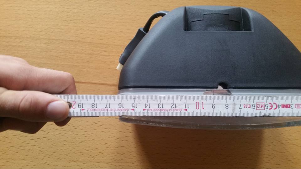

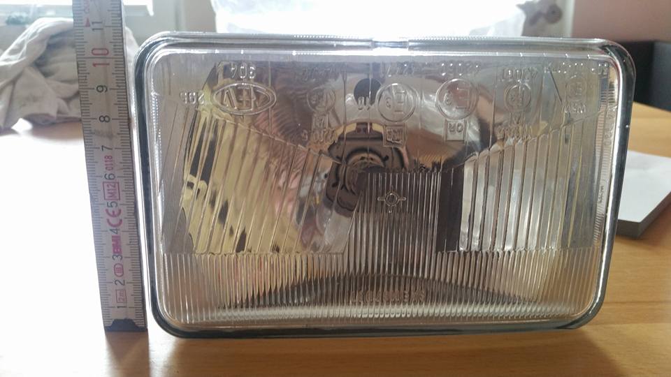

PostPosted: Sat Jul 23, 2016 11:00 am
a guy on the Paso FB group was so nice to check the 750S headlight dimensions (165x105mm)
13680494_1199813610062990_7816166326118312723_n.jpg [41.06 KiB]

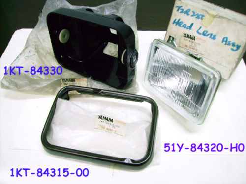

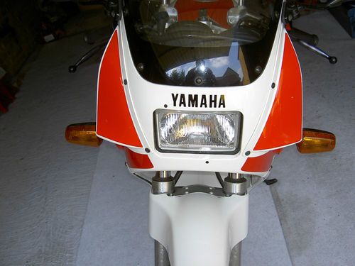

it seems the Yamaha KOITO unit (which was also used on some older XT600 apparently) has similar dimensions. The remaining question is how it can be adapted.
The headlight adjuster screws are in the metal frame. One is positioned in the top left and the other on the bottom. You can see the small holes in the fairing.
