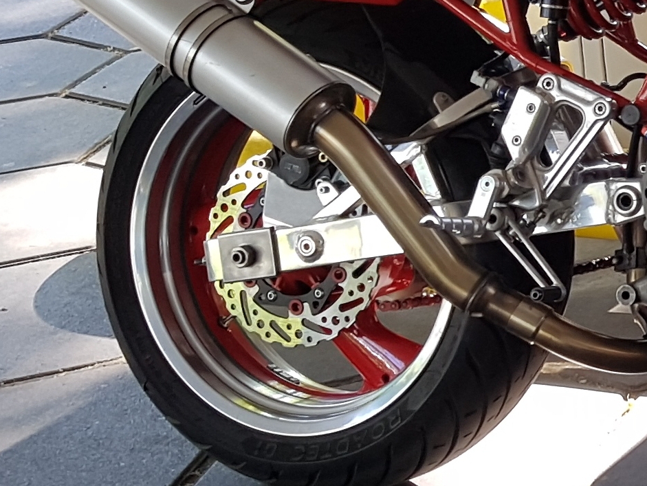

After quite some search throughout the web I finally ended up with a BrakeTech disc.
I was looking for a floating rotor.
https://braketech.com/axis-rear-floaters-2/

From what I understood Michael has the old brake disc on his new rear rim. The brake disc bolt pattern of the 16" and 17" rims is different so the BrakeTech one won't fit.
Looks nice tho. All the rest does, too :thumbup:

Thanks!
I'm not so familiar with the older 16" wheels.
I thought all 17" are mostly the same, except for axle diameter maybe.
