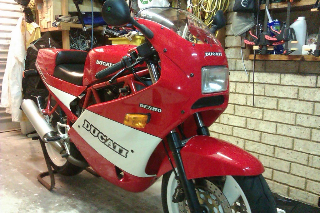

hello , bikes looking great at least you live in a more bike friendly climate and can get ot n about on it .Its blowing a gale and bucketing it down iver here at the mo looking forward to spring .....Enjoy

Nice looking bike chuckozzie, the mods you have done to your bike should make it real sweet, great inspiring stuff
