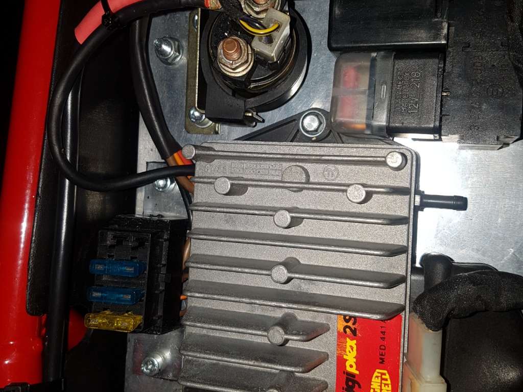

Got some confusion with befitting my main harness, firstly with solenoid and starter motor , should I have a cable between the two , also the small black single cable coming from digiplex unit is just a earth to frame, any help appreciated

I think it's right now , in the 2nd pic I'm about to send does the earth from digiplex carry onto engine as I have shown , 1st pic is solenoid wiring now

Positive from battery - solenoid - starter.

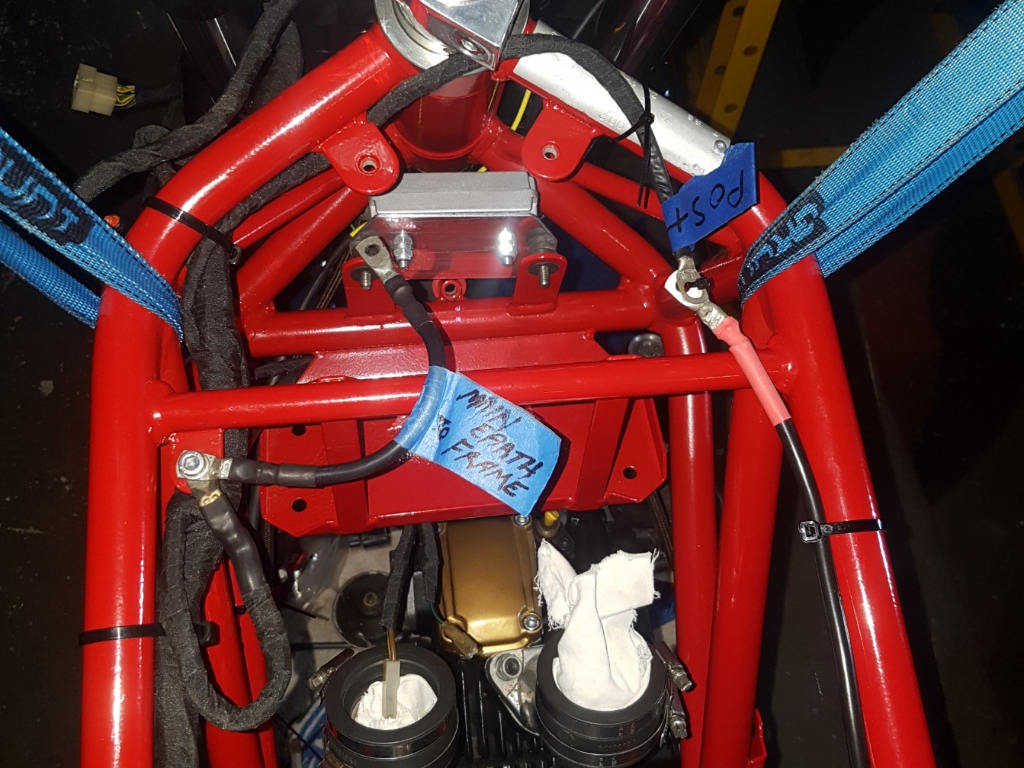

Thanks Gert that all makes sense , in this next pic does the battery setup look right , electrical obviously not a strong point of mine, the next biggie for me will be connecting the regulator correctly , your help much appreciated

The earth strap going to the rear of the engine looks all wrong but was like that when I got the bike , the thread on the case looks to be for an adjustable cable ?

I know it's painful on a new bike but the paint should be removed where the ground cables are installed.

Thanks Matt I will make a new cable ( same size?) Thanks Paso 750 I'm definitely holding off on the vandalism for the earths

Yes, same size cable at least.
On mine I have a Motolectric cable kit.
Maybe you like to read through their blog on that topic:
http://motolectric.com/products/hicap.detail.html
