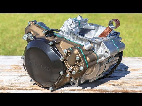

If you want the ultimate in brake-fluid-resistance (e.g. inside of brake/clutch calipers) there is only 1 coating you could use: ceramic coatings (best known and an abundance of colors: Cerakote).
This is completely insensitive to brake fluids.
I've used it on my headers and also on a set of (extra) mufflers but it is also ideal for engine covers.

File comment: example of Cerakote on an engine

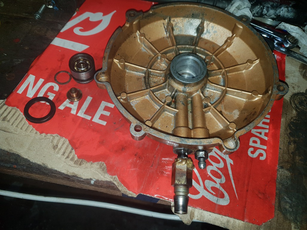

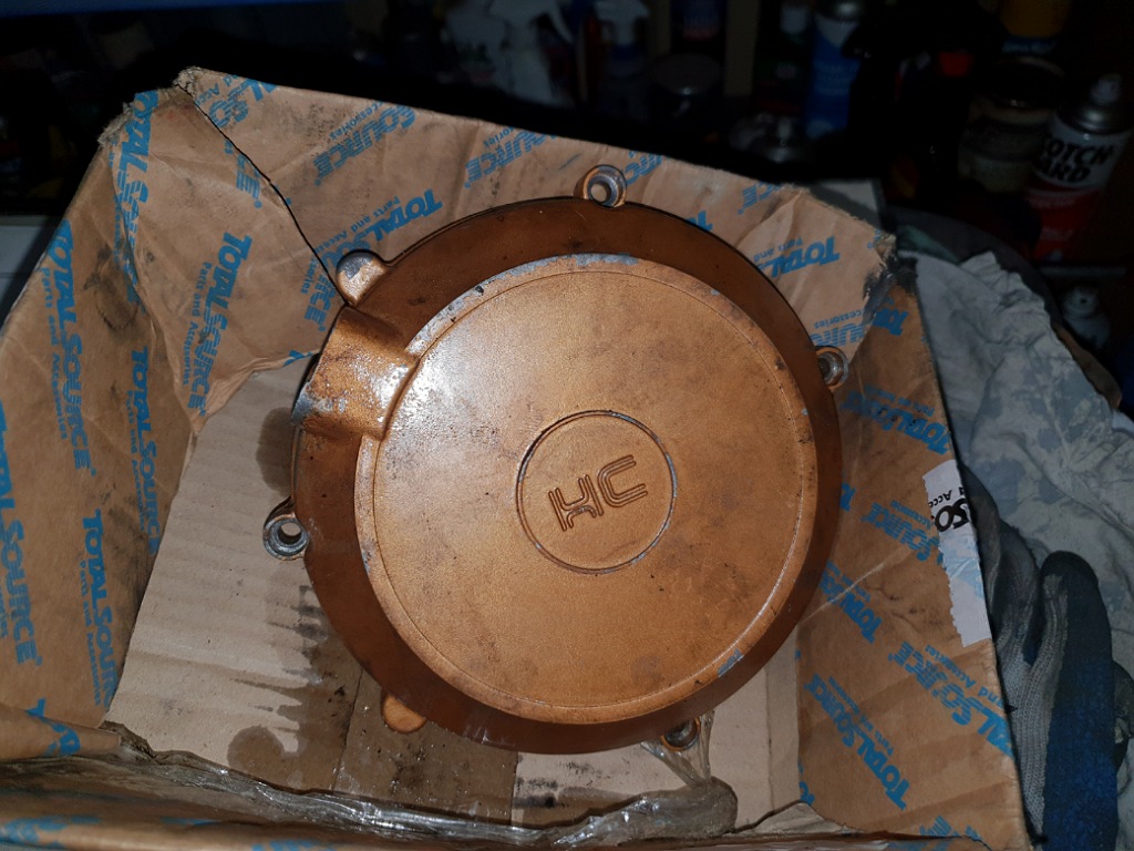

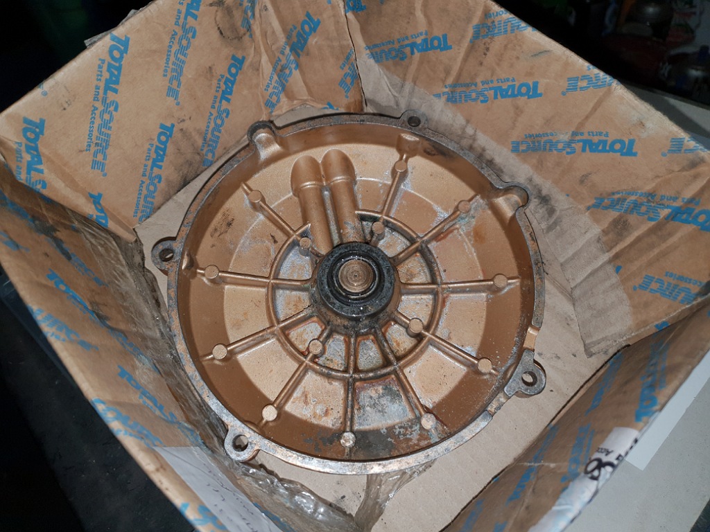

I just opened the package from Rudy, looks sweet, tomorrow I have a go at checking out the slave piston, once again from Rudy always good parts and no mucking around

And again the piston was quite stuck in the bore, air alone didn't work air and a rubber persuader didn't work but the added gentle heat on the boss released it in a big hurry, lucky I caught it in the guts not the head

The bore looks good and the piston looks good, a new seal and a grease should be all it needs, l think this unit cant be stripped any more than what you see and this is different to the piston I have in the 900 but basically same, I think Rudy said this is off a paso
