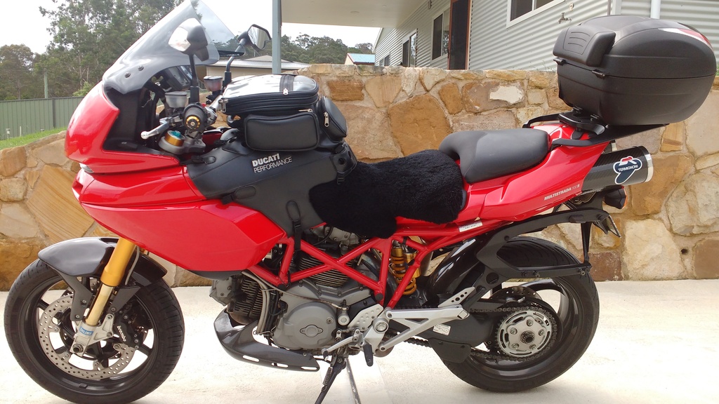

Well I did end up getting another Ducati. A 2007 Multistrada.
It's certainly different from any of my other Dukes. Heaps of power and really quick steering. The ride height adjuster is wound right up so I'll have a play with that and see if I can slow the steering down a bit. I'd also like to be leaning a bit more forward so will have to look into some lower bars.
