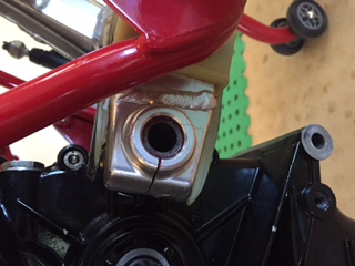

Was originally my intention to build the engine but as my first Ducati in to the 'Proffesionals' ... that & I simply didnt have the tooling required for a major ... more on rebuild later
That said when I picked up the engine the mechanic advised I was missing a swinger bearing (I supplied 3x) which simply wasnt the case as when I supplied the parts manual with a checklist of supplied parts I only ticked off after triple checking they were there ...
The only reason I bother with that story was when I went to fit the missing bearing & seal the thing kept creaping in to the case & it was at that point I noticed the internal retainer wasnt there for the inside bearing to seat on ... that wasnt GOOD!
Insult to injury I then had to replace both bearings & seals after fitting a new internal circlip

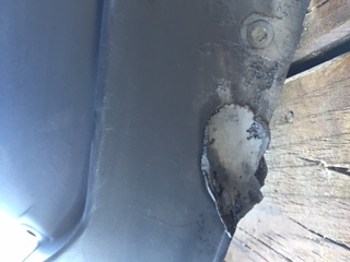

The Hugger needed attention as havent found a replacement ... yup I dont recon. they are ugly & kind of suit the square tail section of the 89/90
Damage occurred when 2x owners ago had the mishap with a truck trailer ... where the hot pipe melted a bit of the plastic
Trimmed, sanded through a few grades & plastic reviver made OK

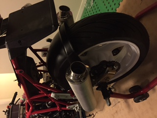

Finally get the exhaust on with those shiny headers
I removed the silencers & popped in perforated straight through & packed with wool ... hope that doesnt sound to raspy (haven't attached photos of that exercise as done to death on the site already)
I did notice when I fitted the mufflers to the headers it doesn't slip on snug .... I may need to get some liquid gasket in there to seal but will work that out when/if I get this thing going

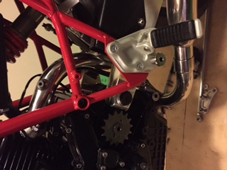

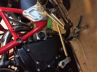

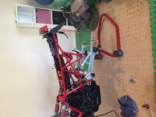

I havent fitted the the front sprocket yet as that was the last seal I needed to complete the engine
But I did install the right hand peg assembly .... there is also a case saver under that guard!

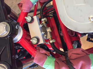

Back to Fueling
I wanted to place a Regulator into the line & was going to mount a gauge showing current/real time PSI ... but wasn't practical to mount anywhere I could view the gauge & wasn't really needed so on the basis I might be able to still sneak in a battery I made a mount under the front tank silent blocks (the silent blocks I found had longer threads on them so that doubled as a mount for the the regulator)
On the return to the tank a #40 jet was sweated in so pressure is good through high flow situations (no doubt someone will probably tell me now not small enough)
Also had to reroute the fuel line the long way around ... I couldn't find any thread that had tried / or done this particular way so again bet someone will correct me on this path ... i.e. will this work?

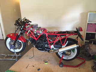

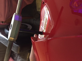

The mudguard on after chasing the threads
Front wheel goes on & the brakes bled (that was easier than I thought it would be as would have thought more air locks than turned out)
The Clutch is proving a sh!t even with a suction pump ... just cant get any pressure at all
