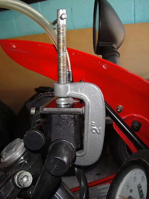

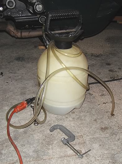

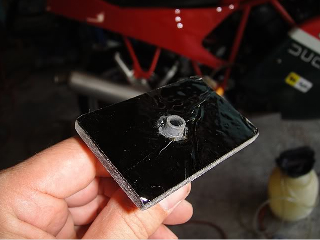

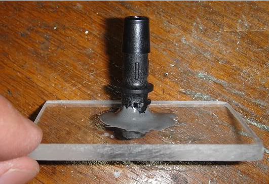

My twin 750 Sports sat for two years and the clutch levers were limp. I tried bleeding as described in the service manual, but pumping the clutch lever wasn't happening. I read a few posts where some of you used vacuum bleeders, but I didn't want to go out and buy yet another seldom-needed tool.
So, I made a pressure bleeder. Clutch bleeding took about 5 mins. total.
Here's some pics:

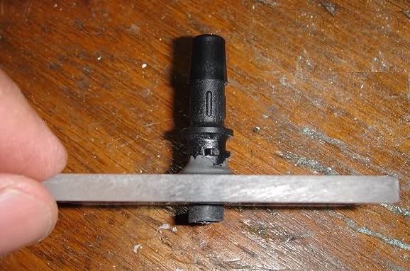

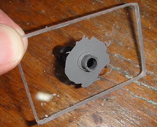

Cut a piece of 1/4" plexiglas a little larger than the top of the MC. Drill a hole in the middle and used JB Weld to secure a 3/8" vacuum fitting.
Affix a piece of rubber/gasket material to the mating surface.

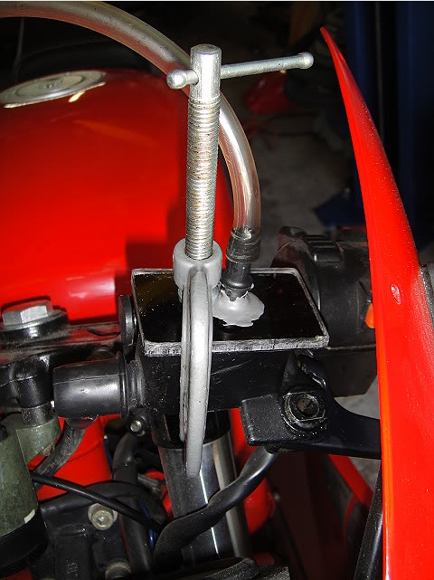

Clamp cover to top of clutch master and attach hose from pesticide sprayer filled with brake fluid.

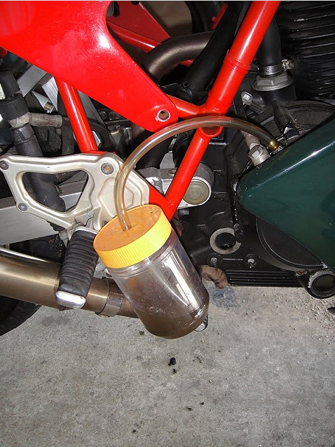

Pump it up and operate the bleeder screw down by the slave.
Pump the clutch lever a few times to test. You will get more air bubbles out doing this. Keep the pressure on from the bug sprayer and keep pumping the clutch lever until no more bubbles. You'll feel the lever getting harder.
Close the bleeder, release the pressure from the bug sprayer. Carefully un-clamp the bleeder adapter (MC may be overfilled...be prepared with rags).
That's it. 5 mins. total bleed time with minimal effort. :choo: :choo:
P.S. - You can use this same device for bleeding brakes, too (motorcycles & cars).
