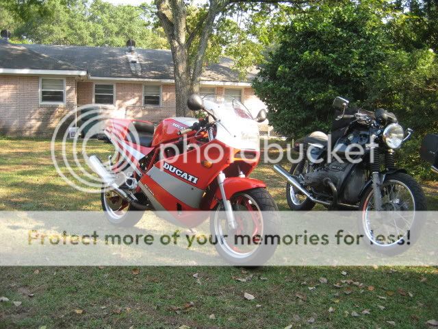

Am currently working on steering head bearing issues. Will try to post pictures soon.

looks pristine!@
is that the one that was on ebay recently that i was drooling over? just wondering where you picked her up.

I bought it off the Savannah Craig's List. It was locally owned.

let's see more of that beemer... we have something in common I think :)

I will post a picture in the off topic thread.
