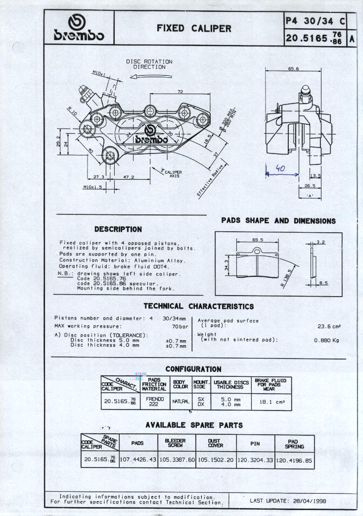

imo those offset problems are just caused by the combination of parts. (old P08 calipers with newer discs). The P08 have a different center position than the P4.
Phil is using the black 4pot Brembo calipers and 300mm Yamaha discs which is the setup of the early 907ie therefore it all fits. Of course he could also fit 320m discs with the adapter just posted and it would still all fit.
Brembo-4Kz.JPG [144.3 KiB]
Not downloaded yet
 Post subject: Re: 17" front wheel brake issue
PostPosted: Thu Sep 26, 2013 2:07 pm
Yeah, the 4 piston calipers have the mounting flanges further inboard, so that the spacers you have against the fork legs won't be needed, and it all fits in tighter and neater. The 4 piston calipers also changed to threaded mounting holes, so there isn't any need for nuts. But you do need to get the mounting bolts the right length, or else they hit the rotor.
Also, confirm that your front wheel is indeed centered. If you use the speedo drive from the 17" front wheel, it will offset your front wheel to the right. The 907 fork leg had a slightly thinner fork leg where the axle goes through the left leg. I machined my fork leg to get the whole thing centered again. (not an simple set up in the mill.) I also tried the old speedo drive, which was narrower, and added washers.
