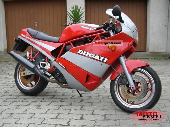

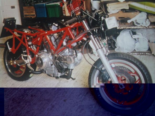

Have already started with engine out and prep'ing it for painting, pic with fairing is before the guy started to restore, other how I got her.

Bike looks nice. I agree with bringing it back to stock.

Thanks for all the replies guys, have been busy stripping the bike (other project - the M900 Café, will have to take a step back for a while!), took the engine out and sprayed it – went for a black enamel in the end – looks pretty good.
