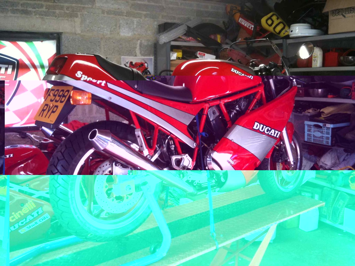

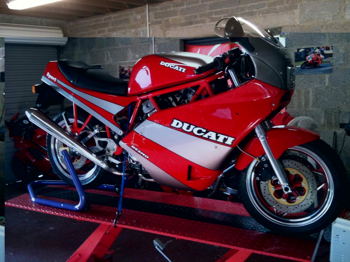

Well as you can see from the pics I have been sort of busy over the summer!
As always the case with these things the bike looked better than she was (although only had 14k km's on the clock) - the org restoration had began in the late 90's and a lot needed to be done (lot was bodged) - so a complete stip down (down to the bottom end)was needed!
Nearly finished now just waiting for the reverse mega's to arrive (had a set of 851 cans on her but didn't look right) and 1 indicator from aus!
She has fired up and is running pretty well on the mik's although front cylinder seems to be running a bit hotter than the rear, but need to get her moving to tell.
Have a few minor fixes that may be asking advise on first being;
- on the parts dia it shows a large spacer along with the speedo drive on the lhs, is this fitted or is it just the speedo drive exploded?
Johnny

 Post subject: Re: New owner with a few ??
PostPosted: Wed Sep 07, 2011 2:14 am
Wow! That looks great.
Nice work.

the only thing I doubt works well is those double bent intake tubes. Not only is the shape no good for proper airflow but the filters are covered by the carb and near the rear cylinder so the intaken air will be hot. Not sure about riding the bike w/o belt covers, too.
A very nice bike though.
PS: Are you one of those guys who spent hundreds of $$$ for a set of new old Michelins ? ;)

Thanks for the comments guys, a few more pics as she nears completion. Just a few more bits n pieces to finish off - weld up link pipes to fit reverse megas, indicator to come from Australia, etc.
The old/new Michelins, came with the bike and they in pretty good condition. She also runs pretty well with the intakes (having a bit of distance between the carbs and filters is a good thing on a road bike (as it prevents fuel misting at low revs).
Johnny
