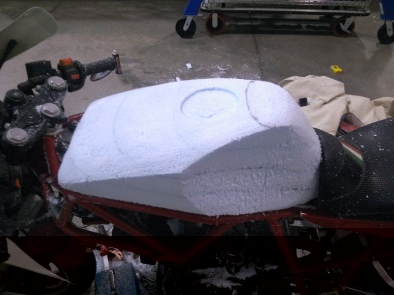

i've attached a few pics of the tank in-process, but i can't seem to find all of my old pics. anyway, the foam is 2" thick dow styrofoam sheet straight from the home depot. cut it up, spray adhesive the pieces together, and carve it to the desired shape. box tape covers the foam. if you do this, pieces of tape should criss-cross each other - makes it easier to pull the tape out when finished. not shown is additional filler i used in the cap recess area, and the mold release agent that i applied all over the tape. you'll notice a piece of aluminum sheet poking out from under the plug near the steering head and attached to the tank's stock mounting points. there's a similar piece at the back. this is molded into the layup between layers of fiberglass. holes punched in the aluminum and filled with filler add strength - aluminum will usually eventually (or immediately) delaminate from a composite structure.

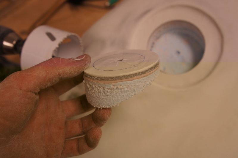

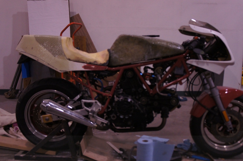

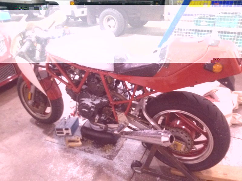

here the tank is structurally done, but before fill and sand. in the previous post you can see the original tail section and corbin seat. below you can see the solo tail molded from the seat. i basically covered the seat and tail with fiberglass to get the basic shape, then laid more fabric on the inside of the tail for strength. then i cut off and discarded the pillion. sand-fill-sand-fill...
finally there's a pic of cutting the filler hole. you'll see a cross-section of layup: on top is microsphere filler, several layers of glass, bondo that i used as filler in the mold, and foam from the plug. the bondo popped off with a little effort due to the mold release.
