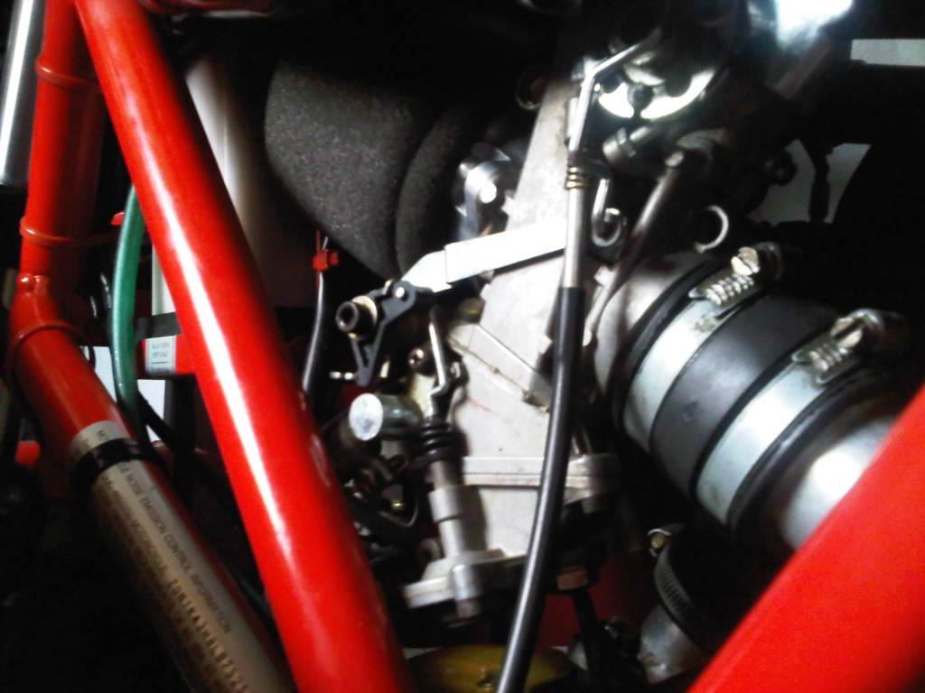

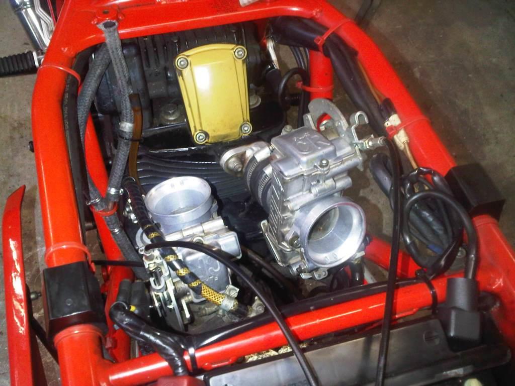

Alternate fitting suggestion
2013-09-15 13.24.15a.jpg [199.1 KiB]
Downloaded 368 times
2013-09-15 13.23.56a.jpg [182.13 KiB]
(Andrew2 please note RED cable ties :lol: )

:shock: wonderful job you've done there Peter.
Andrew
