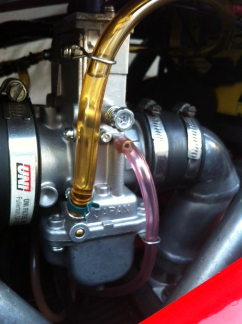

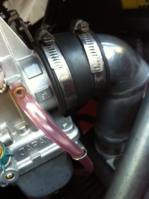

Sean, go all out and custom make one like this, so your carb. can sit straight. :cool:

I'm fairly new to the 750, so I can't comment on the stamping. All I know is that I took an intake from a early 2000 750, cut it up in 3 pieces, got it re-welded, put it on, and the bike is finally running well. :thumbup:

Sorry guys, the intake I cut up for my 750S was from an early 90's 900, not an early 2000 750. :banghead:
