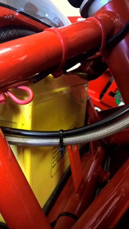

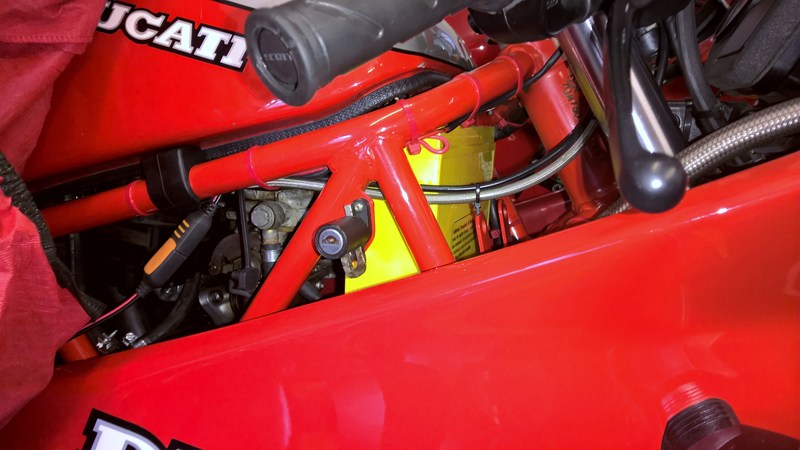

Would you be able to do me a favour and send a picture by any chance? Is your regulator/rectifier mounted in front of your battery? Mine is so I can't insert the battery at an angle without it hitting the bolts that hold the regulator.

I dont think these pictures will be a great help without the tank off :-(

Oh no, they help alright. Thanks :)
I see you don't have your R/R mounted on the two brackets welded to the frame in front of your battery. It's those that stop me getting the battery in (the battery has to go in at an angle because it's slightly wider and it hits the bolts that hold my reg on).
I think I'll have to ditch it. Where's your R/R? Under the seat?
