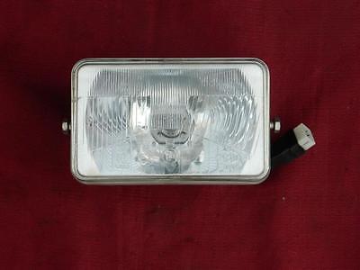

Hella vs original

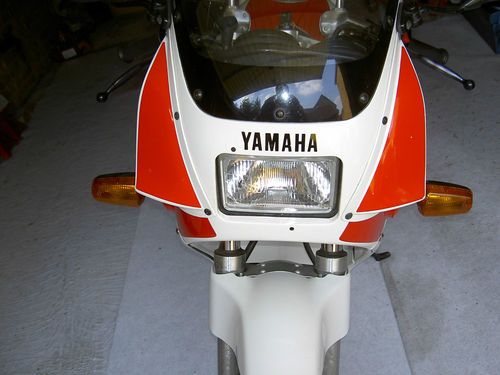

PostPosted: Fri Jul 22, 2016 7:19 pm
the glass of the TZR headlight is 16x10cm

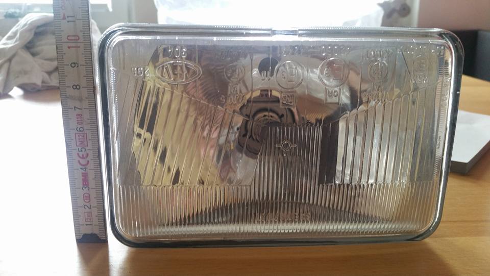

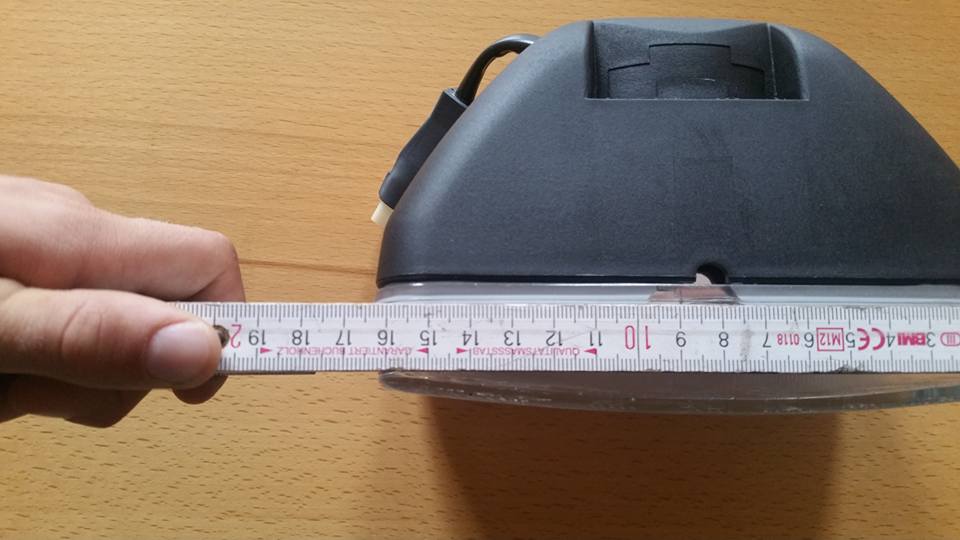

 Post subject: Re: UK Spec headlight
PostPosted: Sat Jul 23, 2016 11:00 am

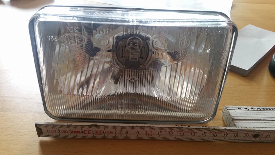

a guy on the Paso FB group was so nice to check the 750S headlight dimensions (165x105mm)
13680494_1199813610062990_7816166326118312723_n.jpg [41.06 KiB]

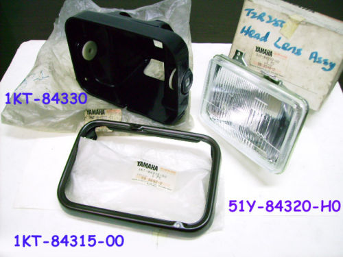

PostPosted: Sat Jul 23, 2016 11:07 am
it seems the Yamaha KOITO unit (which was also used on some older XT600 apparently) has similar dimensions. The remaining question is how it can be adapted.
The headlight adjuster screws are in the metal frame. One is positioned in the top left and the other on the bottom. You can see the small holes in the fairing.
