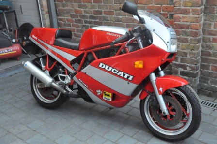

Hi, I've gbought an750 of 90 in reasonable state,
my problem is it doesn't start cold unless i use start pilot, i've heard that the Weber carb is an pain in the ass
I still have two brand new del lorto's with accelerator pumps, but they are 32 mm.
my question is can I bore them to 36 on my lathe or will i destroy them doing that,
and at what angle can i mount them on my motor without having problems with the float level or do i have to modify if the are too much at angle ?
can't wait to ride my duc? going troug the paper issues first
thanks in advance
