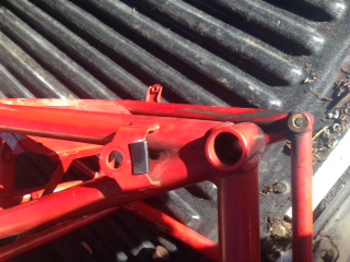

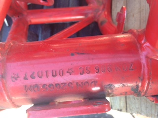

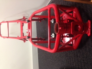

The Frame
After a good close inspection for any hairline cracks … all looks good so had sandblasted & in keeping with original have painted … to keep it tidy went down to the local VIN shop & replaced the tag (good of them to do) as looked a bit huckery next to the nice paint (been sitting for last 3 plus months so paint is nice & hard now)
Basically on the frame nothing to report … tidy example for age
If photo's dont show on this posting then will do when I work out how

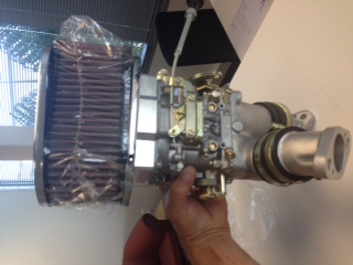

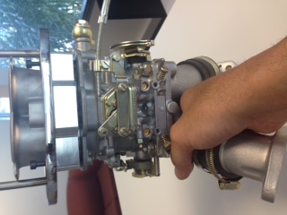

[u]The Weber [u]
Yes I intend to run the weber so have fully rebuilt … she is mint looking (at least) … I have used what was on the machine … interestingly has 116 stamped on the side … will work with it for now
The airbox had been hacked & as I haven’t found an original one yet I thought I would run a K & N …. I am not after revs on this machine (about torque) & all research I have says (no doubt I will be corrected here) no issue with power loss until looking for revs
The weber had been well badly treated (understatement) … only 3x bolts holding the carb & the ones there weren’t done up properly … a drill used to open up jets (way too much) … bent the float to drop fuel level in bowl (presumably attempt to correct flatspots) … seized so filled with CRC & forced to work … a real mess so explains the miss … the flatspots … & the sh!tty power (the engine was a different issue I will address later)
Soooooo hacked the spacer out of the airbox, shaped & tidied so I had a pattern for the CNC shop to shape me a replacement (you will see the shiny plate on the carb photo) … came back spot on except for minor dremel action where inserts in to the carb
I have no idea on the jetting but the very helpful weber guy said use standard, but up one on air jet as baseline & tune with the right gear once running
I wonder if my allumium plate will create or diminish icing? … would imagine more icing issues if anything
Attached Pics after rebuild ... the sh!tty choke cable was on the unit ... I have OEM replacement when I instal

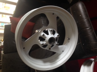

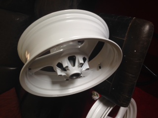

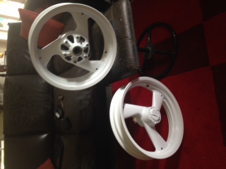

Wheels
Standard 17" rims & were in not bad nic (old but low mileage machine so wear wasn't the issue on this machine which again was my preference when looking for a project) ... the only blemish was road rash on the front rim when it went down the road two owners ago which is why the machine had been sitting around for a few years (that same rash scarred the fork but that is a different post)
That said the excuse I needed to remove the rubber & bearings for tidy up
Had the road rash welded & shaped (I was going to shape with my trusty dremel but the mag place did it without me asking) ... great job as couldn't pickup where minor rash was & was in an area where the heat from the weld wasn't going to impact on the integrity of the rim (win win) ...
On researching one place was going to weld, shape & then paint (after etch primer) over the existing original powder coat ... but not my preference as whilst would have looked good now the etch primer was only going to be as good as the original powder coat ... lets face it powder coat only has a certain life as the aluminium will chalk up at some point (25 years old now)
So down to my sand blaster (gives nice surface the powder can take to) after cutting dowl to fit where the now old cush drives were & bolted ply over where the bearings sit (very snug so no blast impaired those surfaces underneath) ... clean as a 20 year olds landing strip!
Not all coaters are the same ... the guys i used spent time with me as I wanted areas masked & wanted the Zinc pre coat (which whether right or wrong was advised will also prolong aly applications) ... no matter what I wasnt going to etch & paint old powder coat no matter how good that appeared ... & was originally P coated (stand to be corrected there but looked PC) ... & for the rims just better wearing
Maybe someone can confirm Powder Coated with Zinc pre-coat correct application on Aly as well?

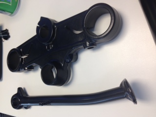

Triple
Just wear so blasted & painted with the hardest automotive flat black I could ... came up nice

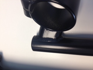

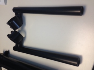

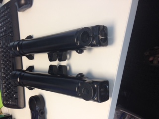

Clip-ons
Were a different story in that the bike had some shocking aftermarket crappers that had no risers so the crappy lock to lock on a 900ss wasnt even reached as the clip-ons wouldn't allow (when I test road I did a 6 point turn ... not the awesome 4 point turn we should get)
Finding original clip-sons was a mission & after finding some at a wreckers 1000 kms away had sent up ... was told pretty ropy condition but when I opened the packet they were both bu@@ered ... the bars were both bent & so bad they had broken the welds (very bad)
The wrecker felt bad enough to throw 20% refund in cash in the package ...really were throw away
Anyway used the same welder that did some other work ... stringlined & welded in some new bars (took a while as he had to order in the right material)
I show a closeup of the weld ... that was very nice
Sandblasted & Painted with same automotive flat black
Sidestand
Awesomely bad design ... but standard it is ... blasted & painted
Forks are with sidestand but that is a different post as haven't put together yet as still trying to find new internal smaller bushes for the M1BB (I have larger internal bushes from Steins) - if anybody knows where I can get these stanchion bushes from would be bl00dy good
Serious road rash had ground out the bottom of the fork ... again welded as the rash was on a thicker part the weld didn't impact on the internal integrity ... then shaped on my dremel before blasting & painting ... came up good

Closeup on Clip-on weld

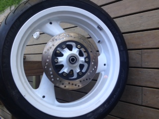

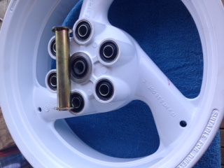

Back to the Wheels
New Bearings installed
New Cush Drive bushes installed
New Michelin Pilot Power 2 installed (got a reasonable deal on a tyre that will out perform me)
Just waiting replacement bolts before torquing the disc's back on
White looks good in a showroom but keeping clean is another thing ... in keeping with standard it had be done & doesn't look bad

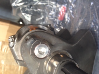

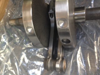

The Crank
I have half posted in Small End Enquiry but to keep thread together fill the spaces
While all the other stuff bubbling away I had the Crank Balanced, etc, etc
Bottom End

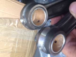

Small End (Nissan GA16/RB4107 19x22)
High Comps going in 11.5:1 JE's (whilst a standard build these can be changed anytime)
New Bolts
Oil Gallery replaced (Locktite & particularly asked to be staked)
Balanced to 52%
Polished
The Engineers List
REMOVE CON-RODS FROM CRANK.
REMOVE 2 X LITTLE END BUSHES FROM CON-RODS. MEASURE NEW BUSHES,
FREEZE FIT NEW BUSHES TO CON-RODS, DRILL OIL HOLES, HONE BUSHES
TO SUIT GUDGEON PINS. CLEAN, ALIGN CON-RODS, FIT BIG END
BEARINGS TO CON-RODS, CHECK CLEARANCE IN SPEC. & REMOVE BEARINGS.
BALANCE 2 X PISTONS, 2 X CON-RODS, SET UP BOB WEIGHTS, BALANCE
CRANK 52%, POLISH CRANK.
REMOVE OIL PLUGS FROM CRANK, ACID TANK CLEAN CRANK.
FINAL CLEAN CRANK, FIT OIL PLUGS, LOCKTITE STAKE OIL PLUGS, FIT
RODS TO CRANK.
Very comfortable with that as knowing a few people up with Machinery reinforced this shop is very good
