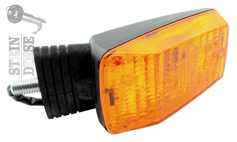

I`ve been looking for some info and found the following. This is just a basis for someone else to follow up on and verify.
The indicators are two pieces. Body and socket.
The indicator lens should have the marking "CEV 291" or "296" on it. It`s the same as the RP 180 lens from BOSATTA. (http://www.bosatta.it/prodotto/rp-180/)
The indicator body is used on numerous bikes with varying sockets.
Aprilia ETX 50-125-350-600
Aprilia Tuareg 50 & 350
Benelli & Garelli Atala
Moto Guzzi Targa 750 - Le Mans 1000 - California III 1000 - SP 750 - GT 1000 - V65 Florida - Strada 750-1000
Gilera 125 RX 125 Enduro
Malaguti Fifty (the blinkers seem to be identical to the Ducati ones / 2nd pic below)
and others
part numbers are:
GUZZI 23750670 (chrome body) - 30750610
DUCATI 067599400
GARELLI 5107616501
MALAGUTI 01900600/700 (long socket)
APRILIA 82.12.032/264/342
LAVERDA 76.119.264
The correct body/socket combination corresponding to DUCATI 067599400 seems to be FR3B on this page and they are apparently still available.
http://www.nonsolofrecce.com/index.php? ... gory_id=14
Bergamaschi lists them as F100947700 CEV on p.3. At the end of the catalog there`s a list of all bikes and parts available. The Malaguti Fifty is listed the Sport is not. However to me those parts look the same.
https://app.box.com/s/lcpv3sqsspiavam79xol5xuretpgm7f3
I don`t have a Sport so I`m not following up or digging further into this.
Btw some similar aftermarket parts don`t look so bad and are probably cheaper.

http://www.stein-dinse.biz/Ducati/Elect ... 52101.html
2004 ST4S
2001 ST4
1987 Paso 750

Stein Dinse doesn`t have them, they can only preorder them.
I have sent an email to the company in Italy (writing in italian) a while ago but did get no reply either.

I ordered mine from Stein Dinse and they shipped them promptly.
