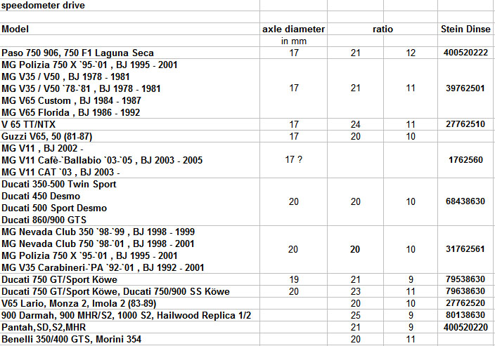

a while back I was looking into speedometer drives and checked for similar narrow ones. I only looked for parts used on Ducatis and other italian bikes. Noone had the same ratio.
