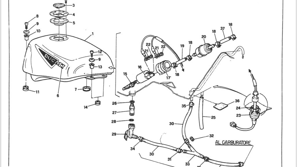

I have to double check, but yes they should be what I remember. When opening the fuel cap I can see fuel rush inside the tank when pump is running. Isn't this sign of correct connection?
You mean the number 6 rubber?
 Post subject: Re: 750 Sport run issue
PostPosted: Tue Jun 12, 2018 11:15 am
as in your picture the return connection is the one on the outer side. It sounds ok.

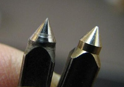

question... is the fuel pump "original"? I mean the one for carburated engines?
the IE version is exactly the same from the outsice but pumps @ over 3BAR and you will need a pressure regulator to make it work correctly with the Injectors.
in your case even 1.5 bar are too much, the carburated version should be less than 0.8 (I think) or it WILL push the float valve and flood the carb.
If the Pump was replaced (or the tank) you need to check you have the correct one.
then you need to check all fuel connections are correct and also check the return is free, if the jet in the return line (#32) is full of dirt then your return is not working causing the pressure encrease in the system.
you need to check also the float valve, it is a cheap component and is worth renovating it anyway.
