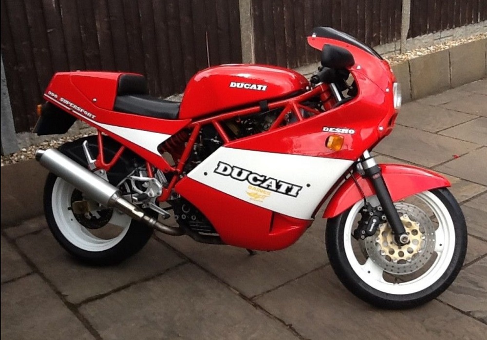

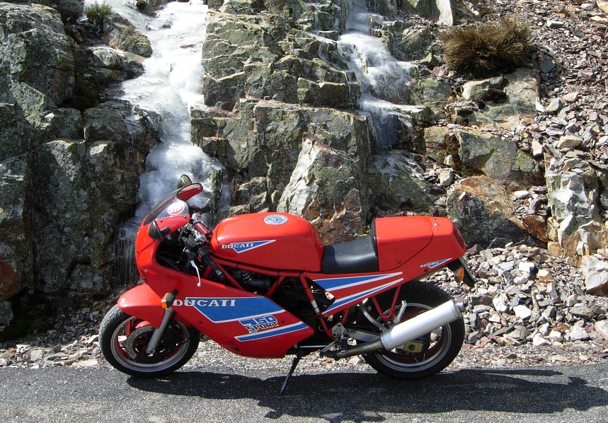

I want to get back on the road with my ducati 750 Sport, which I had in a corner of my garage.
I have come back strongly, and I bought a 900 Supersport 90 in England.
As an amateur mechanic, and with his help I think I can get ahead, with the return to the road.

Btw. that is a nice and clean looking 900SS :thumbup:
