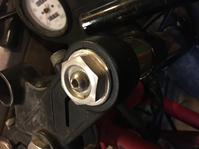

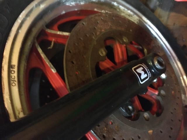

Posts: 86
Hopefully photo attached. Those more wise on such matters will tell us if the top is standard or part of the maxton upgrade

Thats different from my top cap, but also different from the top cap on the kits they sell now I think.

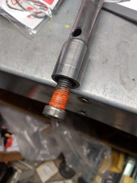

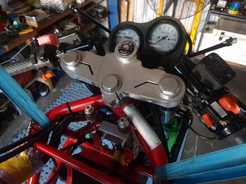

I know what You are saying and dont disagree. And I will do just that for now. However I know from MTBs with fancy suspension that some fancy dials can do a big difference sometimes also.
And Yes the legs are compression in one and Rebound in the other. Quite basic stuff. Always a joy to see no copper washer and loads of silicone..

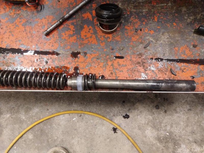

Better late than never, I think and hope this is the original topnuts for the standard forks on the 89/90 900 SUPERSPORT, I've rebuilt these but not had the chance to see how they work
