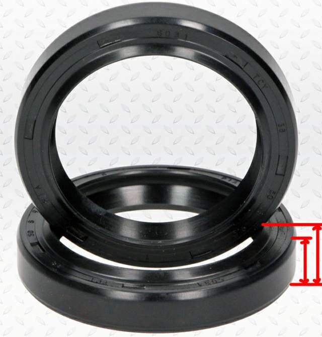

Make sure to get oil seals in the size 41,7 x 55 x 7,5/10mm. The 7.5mm is the height. Often taller seals are sold for the Paso but you´ll run into problems installing them.

the 7.5mm is the height of the shoulder, the 10mm is the total height including the inner lip.
The overall height is not that relevant. The shoulder height is what determines if the lock ring which is installed above the oil seal fits in its groove or not.

Thanks, that makes it perfectly clear. The stockists I look up for seals usually just quote the height to the shoulder, not the overall height.
