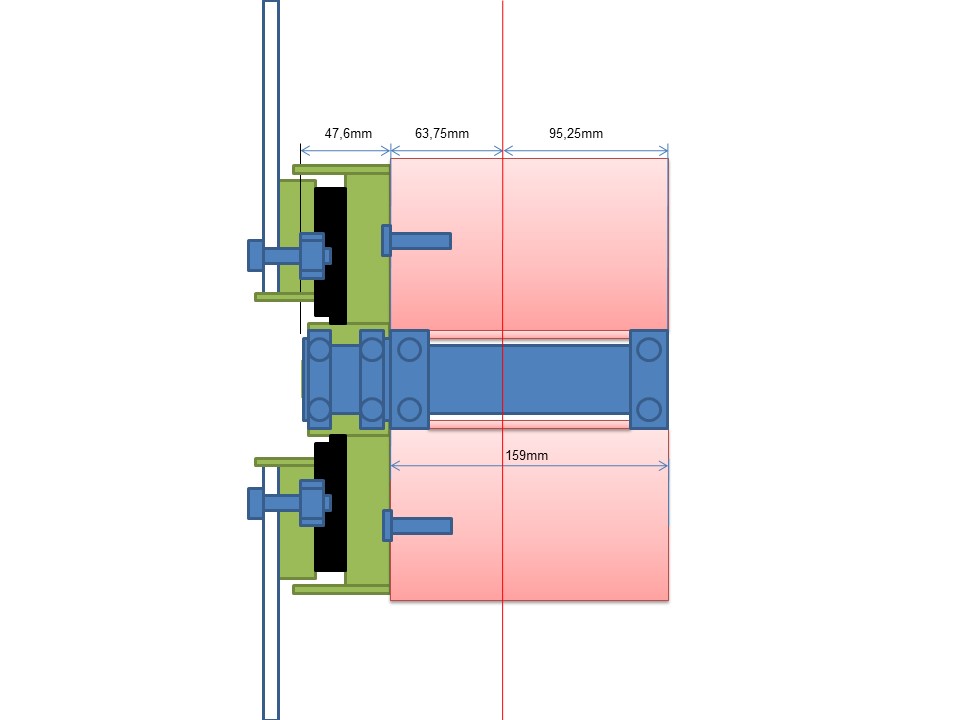

Hello i was wondering if anyone know how wide the 906 paso wheel is at the hub ? i mean from spacer to spacer with the sprocket hub in place .

not sure what you mean by from spacer to spacer but the width at the hub is 159mm rear, 125 front rim

i mean how wide the wheel is in the center ,lets say when the center bolt is put in and then make a mark on each side of the center bolt with the spacers . That was not easy to explain :D
But i guess the answer you gave me is that measurement?

my dimensions are the width of the rim at the hub. Basically outer side of one wheel bearing to outer side of the other. The pan of the sprocket carrier included it`s ca 207mm width

Thank you that is the measurement i needed .
