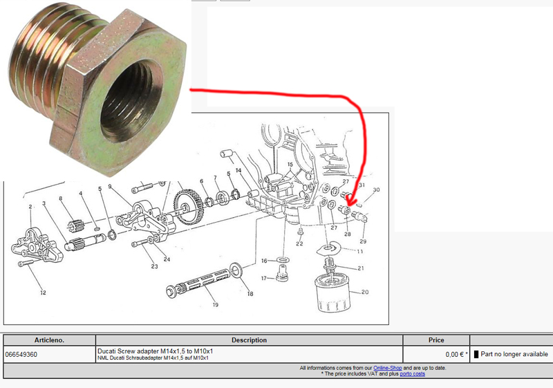

Part numbers are always useful... as I’m chasing one these myself. Pretty much any search for Ducati oil pressure switch is bringing back the M10 thread spec when the Paso’s are an M14 thread.
Anyone got a model I can use to narrow the search?
 Post subject: Re: Oil Pressure Switch
PostPosted: Sat Aug 10, 2019 9:53 am

Thanks for the prompt reply, I think to make things easier in future the thread adapter is the way to go.
Found an adapter
here's another closer to the part in the diagram
Also, while I'm waiting for the adapter to future-proof my engine, I found the Renault 25 uses compatible switch.
