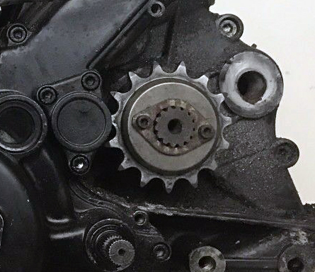

750 and 906 Pasos have different part numbers for this part.
But can one from a 750 fit a 906, or is there an important difference?

Some times the quickest way to find out is to go to good ole eBay ( or elsewhere ) and see if you can't view pix of parts for sale. I thing the 750 and the 906 motor are based on different crankcases so it probly is different

The cover on the 500 and 600 Pantah engines are certainly different. I'd assume that the 750 Paso engine which is based on the Pantah engine is also different.

The Paso 906 here has the clutch slave cylinder on the right.
So, a Paso 750 sprocket cover should be OK.
Thank you for the info.

Ken, you're right. My bad.

The sprocket cover was described as fitting Paso 750 and 906.
It fits perfectly, with a cutout for the dummy clutch slave cylinder.
