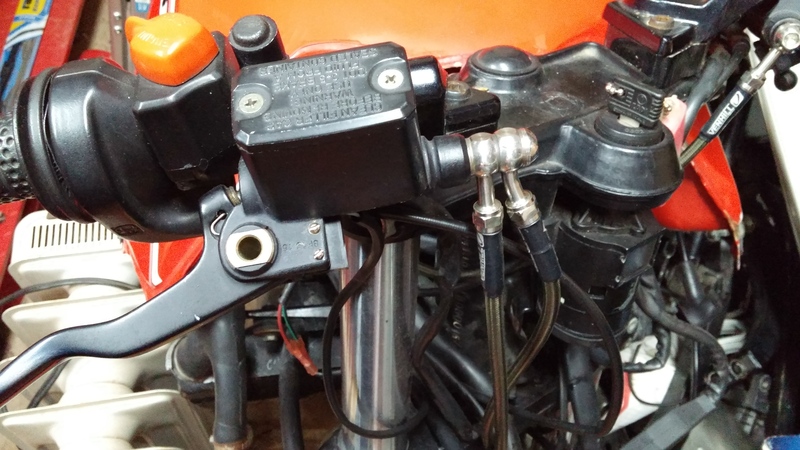

I went with the Venhill and ditched the splitter. Got a microswitch from Bevel Heaven to keep the brakelight on my 906.
