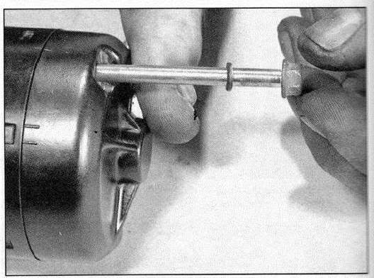

I don`t see the alignment marks on the outer part of the center body. There`s a square instead of two lines.
from section 8-22 (many other detailled photos there)
http://www.box.com/public/oq4fober14

Yes the only alignment marks are down at the bottom if you look at the picture i posted and there are none at the top aside from those on the End Cap. I took the starter to an Auto Electrician and he had it turning clock- wise on the Bench and in the mean time i got a second hand one and fitted it and run it. I have not heard back from the Auto Electrician but will contact him in the morning.

The marks on the center housing that can`t be seen must be on the rear side which would mean the end cap isn`t mounted right. At least there should be some. As mentioned a square not two lines like on the other parts.
Assuming your new one works correctly did you check it for the marks ?

Here is what it should look like,sorry for the poor quality,in the middle of getting the 907 up to speed for a SPIRITED ride this Saturday, belts,sync and valve check. Ran into some PO issues doing the belts and had to scramble for good parts from a real hack job :wacko: :zip: :,(

so the marks in the front and rear are on the opposite side and Harry`s endcap is reversed.

Yeh i should of mentioned that i did get the Bike going with the secondhand Starter it only cost me $20 because it had been sitting in a parts bin for a long time so i was happy with that purchase and i have talked with the Auto Elec that i gave the original Starter too he said that at some stage the Starter has been reconditioned totally and that the way it goes back together to turn in the correct rotation does not have any relation to the Marks that are on it? im not sure how that works but he has it re-assembled and has put new alignment marks on it so that when i pick it up it will become a spare i did read somewhere that when they recondition that they will totally rebuild Starter Motors with new windings and Magnets etc so yes i wonder if the owner before me had done this and he was the one that new how it went back together. Next job on the list is coil replacement with Dyna Coils should i run 3 ohm or 5 ohm.

:lol: :lol: :lol: :lol: :lol: :lol: :lol: :lol: :lol: :lol: :lol: :lol: :lol: :lol: :lol: :lol: :lol: :lol: :lol: :lol: :lol: :lol: :lol: :lol: :lol: :lol: :lol: :lol: :lol: :lol: :lol: :lol: :lol: :lol: :lol: :lol: :lol: :lol: :lol: :lol: :lol: :lol:......... It's happened again,I don't feel so stupid now. knowing that at least 3 other members have put their starter motors back together ass about and spun them backwards. J
I should note that I just stumbled across this thread ,as I dont read the 900 forum very often,but I helped someone else on the 750 thread with the same problem last year, as I had done the same thing the year before :lol: :lol: I thought G participated in that discussion ? anyway This time it should be labeled clearly in its own thread,before someone else considers pulling their engine apart to fix a simple mistake. :banghead: :banghead: :banghead: J.
