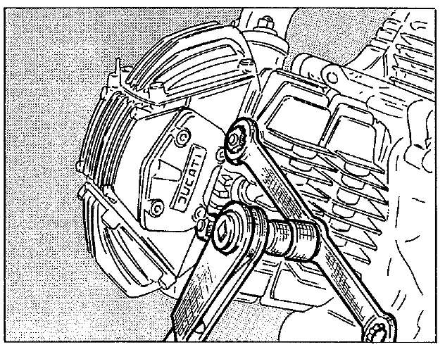

Just for the record: the distance between the ring and the weld socket nut (special tool for the cilinder head nuts) is not relevant: as long as the torque wrench is attached perpendicular the set torque is correctly applied (physics).

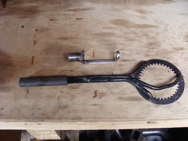

Here is a pic of my cylinder head nut spanner , and clutch tool , cant find one of my closing spring tool thing.
Regards
Hamish
