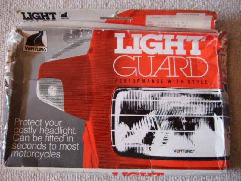

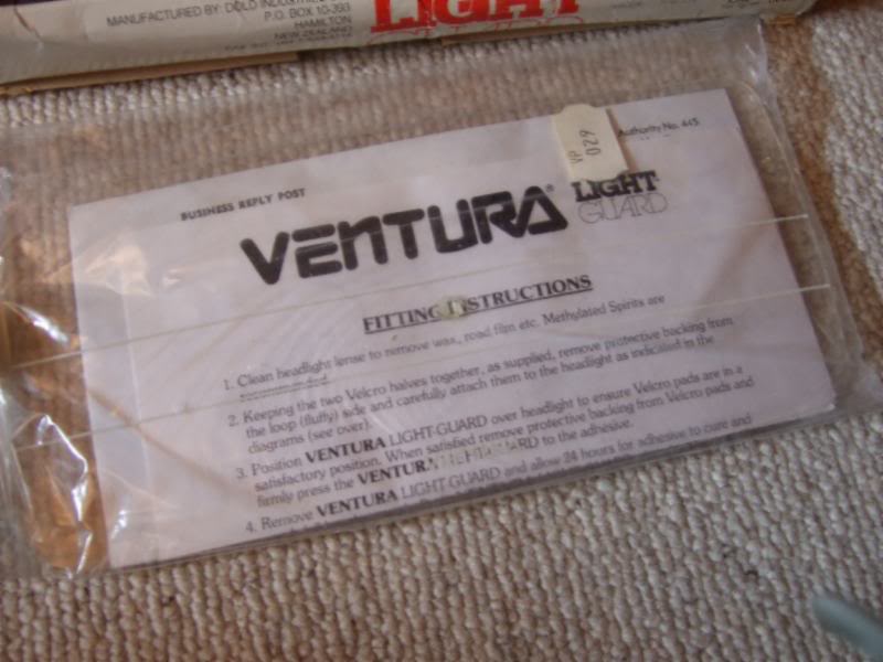

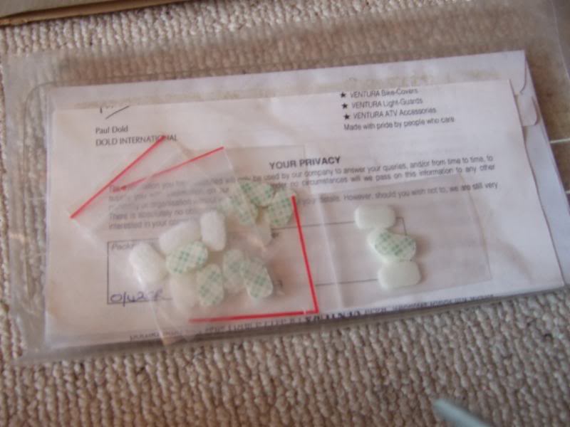

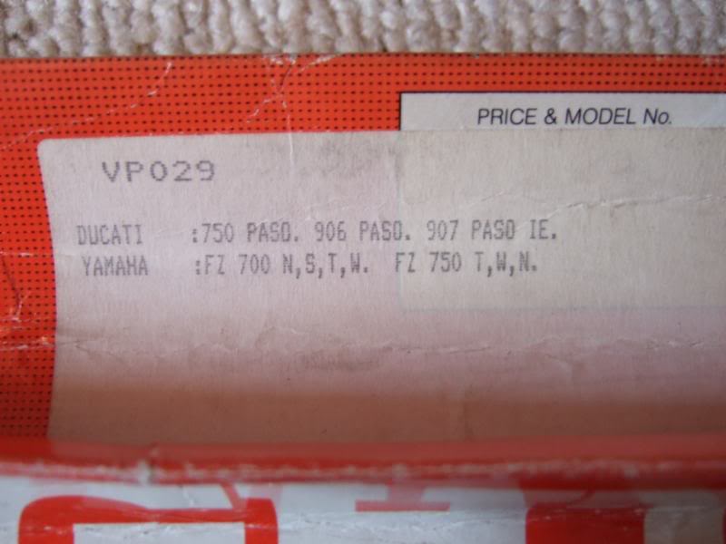

headlights from a Yamaha FZ 750 Genesis usually are not very expensive, at least not used ones.

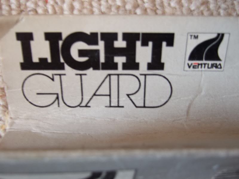

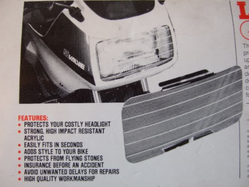

Those headlight covers can also be bought. Ventura Light guard (model VP029) from New Zealand
I have one just as a collectors item :mrgreen: :roll: I wouldn`t use it as it`s probably not legal here anyway and how it affects the light cone is also unknown
btw Ventura also lists luggage carrier racks for the 906 and 907ie
http://www.ventura-bike.com/fitments.aspx?modelid=117

Ventura accessories are readily accessable here in Oz, I have used various equipment of their's over many years and many bikes, including Dukes.
I would certainly recommend them, always fits first time, instructions are good, gear is tailored to the bike model. There is not light distortion that I could notice with the headlight protector fitted. I wouldnt bother trying to make one, given the time it may take to do it, getting the dimentions right etc. Their protector comes in the right measurements with velcro fasteners, curved to the shape of your bike and with what appears to be a bubble of ...silicon on the light side incase of impact, which absorbs that plus keeps the protector contating the light directly.
What more can I say. I dont have a vested interest in the company, just recommend their products.
